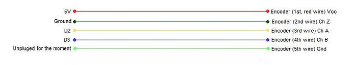

First of all, here's the wiring diagram.

Surely, the encoder needs stable 5V and GND. Grounding the Z output isn't good, either.
Anyway, good luck.
oups, you're right, channel Z is unpluged and the ground of the encoder is connected to the arduino ground.
