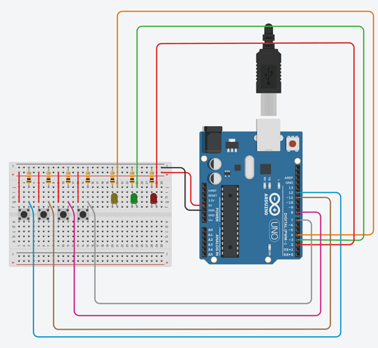

I have 4 push buttons (from left to right in the attached image: AutoRaise, Limit Switch, Stop, ManualRaise.) and 3 LED's. The general premise of the system is:
  1. AutoRaise: When pressed and released, the orange and green LED's remain on, i.e. latched, unless the limit switch or stop buttons are pressed.
  2. ManualRaise: When pressed and held, the orange led remains on. if the button is released, the orange LED turns off.
  3. If the limit switch is pressed whilst the manual raise button is held, the orange LED turns off.
The following code worked last night, when i've tried it again today it no longer works, i.e. pressing the manual raise button does nothing and i can't figure out why since nothing has changed. All other functions work as normal, therefore it's not the arduino. I've replaced all wires, resistors, tried different pins, nothing seems to work.

The line of code that is causing issues is:
else if(digitalRead(ManualRaise) == HIGH && digitalRead(LimitSwitch == HIGH)){
    digitalWrite(led, LOW);
Removing this part of the code allows the manual raise button to work as required, however pressing the limit switch whilst manual raise is held no longer turns off the orange LED of course.
Can anyone spot why this might not be working?
The Arduino has built in pullup resistors. So much easier to wire switches when using them. Why aren't you?

If the code worked yesterday, but not today, and you made no changes to the code, then the code is NOT the problem.
Should that be
if(digitalRead(ManualRaise) == HIGH && digitalRead(LimitSwitch) == HIGH){
evanmars:
Should that be
You're probably right but why would that have worked yesterday if it is the solution?
evanmars:
Should that be
Yes. This is it. I have no idea how/when thats changed, maybe i'm a sleep-arduino-er. Thanks for taking the time to look through!

Is it literally a case of INPUT_PULLUP instead of INPUT at the void setup stage?
hahapointtaken re. }else{
It's not as simple as that. You need to connect one leg of the switch to ground, and one leg to the digital pin, and to expect that HIGH means not pressed and that LOW means pressed.
While that last part seems confusing, if you think about pushing down on a switch to complete the circuit, the top of the switch is high(er) when not pressed, and low(er) when pressed, so it is easy to keep track of what value to use in if statements, to get the desired results.
