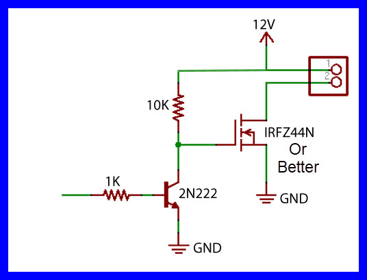

I am building an RP2040 based board which is going to operate car ABS solenoids.
That introduces two main challenges:
  1. Solenoids have very low impedance (some are as low, as 2ohms). So it is crucial to get the N-Channel Mosfet properly open. Most of logic-level ones still have pretty high resistance at 3.3 Vgs (like IRLB8721)
  2. Is, obviously, safety. So it would be wise to get Mosfets protected from Vgs overload. I know it could be done with two zeners, but there's two more components for each channel, and board is getting bit too big already
So, I wonder, if there could be a simple, compact (SOT-23?) Mosfet driver, which will rule out both things for me?
Thanks for your attention!
  • Assuming a 12V power supply, don't use a logic level MOSFET.
  • Add a fuse to the circuit (12V / 2R = 6Amp) a 10A fuse will probably be fine.
  • Add a kickback diode across the solenoid.
  • If the selected MOSFET, Vgs(max) is < 12V, add a voltage clamp zener to protect the gate.

That was a super quick reply :slight_smile:
Pretty neat and simple solution, thank you!
Those are definitely must! I expect solenoids to kick real hard, hehe
Other than that- am I overthinking the whole gate protection thing, and flyback is the only precaution to really take?
I am integrating it into existing system, so fuses (on high side) are taken care of already :cowboy_hat_face:
  • MOSFETs have a maximum voltage the gate to source can withstand.
  • If Vgs is greater than Vgs(max), the gate can be damaged.
  • A zener can be placed across the gate to source to keep us from destroying the MOSFET.
  • In this HIGH Side Driver (P MOSFET) we see this zener.
Yes, there are compact MOSFET drivers like the TM SOT-23 Single Low-Side Driver IC and IR44273LPBF. It features CMOS Schmitt-triggered inputs, under-voltage lockout, and is compatible with 3.3V logic. This driver can help ensure the MOSFET fully opens and provides some level of protection. Other recommended options include ZXGD3003E6Q, MCP14A0051T-E/CH and TPM27517-S5TR. They are also compatible with the 3.3 logic and have good temperature range.

Is one side of the solenoid connected to chassis ground?
You're the best! That's exactly what I was looking for. Many thanks!
One side is connected to 12v through the fuse and relay, and other- is pulled to the GND with N-Fets
