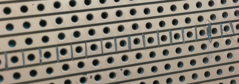

This is an example made with a scalpel of how you can cut tracks between holes.
This is an example of cutting along the length of a track so you can use surface mount components with 0.05" pitch.
Grumpy_Mike: This is an example of cutting along the length of a track so you can use surface mount components with 0.05" pitch. |500x318

Yes it will cut the track, but if you think about it this will leave a raised length of copper that might make contact again if it is pushed down. I would double check by going over the cut with my finger nail, smoothing it down. Then check with the meter again.
