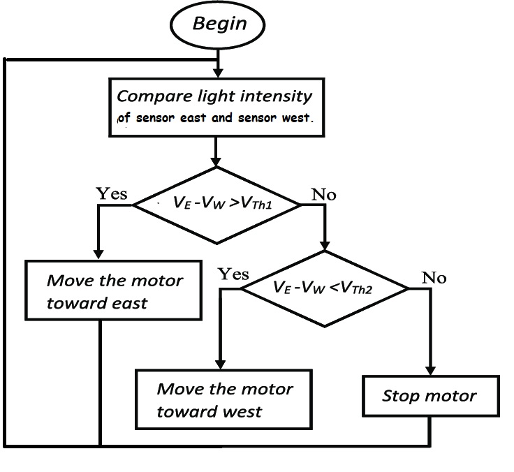

You could do it that way, but how would you know which way to turn to get the maximum combined output.
The usual way is to read each sensor and compare them, the higher sensor will be at the closer angle to the sun.
You then turn your PV panels in the direction of the higher reading, until BOTH sensor values are equal.
Google;
arduino solar tracker
This simple flowchart may help.
Many thanks Tom, I guess I didn't make it clear in my pdf 'plan' - the combined voltage is just for the arduino to know whether to progress to the next step or not, if the voltage is higher than the defined value then to energise the relay corresponding to the side with the higher voltage until the voltages are equal :slight_smile: That way in low light conditions (cloudy days and night time) the panels will remain in the level position.

The code should be fairly simple. You'll need to figure out if the Arduino can drive the relays - sometimes the coils need more current than the Arduino can provide. Also you'll need to defend against the inductive spike when they turn off, unless that's already taken care of.
Then there's measuring the voltage. As long as the mini-panels never produce more than 5V, an Uno can read them directly.
You might consider setting up a breadboard and components to simulate your system, so you can test the code without climbing the ladder and having to wait all day.
Many thanks wildbill! If the arduino won't drive the relays that I have (that are quite small and only switching 12v at about 1-1.5 amp) I could use relays that come with and 'arduino kit' to work my relays if need be....
The mini-panels produce a maximum of around 2v each - I have never seen them even in 100% full sunlight make more than that :slight_smile:
The breadboard idea definitely is the way to go for testing!
