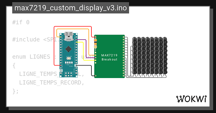

I'm looking for an Arduino/Circuit simulator that I can use to breadboard a project I'm working on before buying all the supplies. The project uses a few MAX7219 chips.
I took a look at Wokwi but their MAX7219 is the Matrix display, I just need the chip to drive some (a lot of) seven segment displays.
Anyone know of a simulator that does this?

In fact, one of the examples/tutorials is creating a 7 segment driver chip: Custom Chips: Create your own Virtual Hardware (For Elektor / Espressif Blog) - Google Docs
Yikes. Implementing this chip in C is outside my abilities at the moment. I was searching for a more plug-and-play option
Yeah, too bad. And implementing this chip in C does look daunting, if you were to do a full job of it.
Sometimes when wokwi doesn't have a pert, and even times when it does, it is easier to use some vastly lower rent hardware as a proxy.

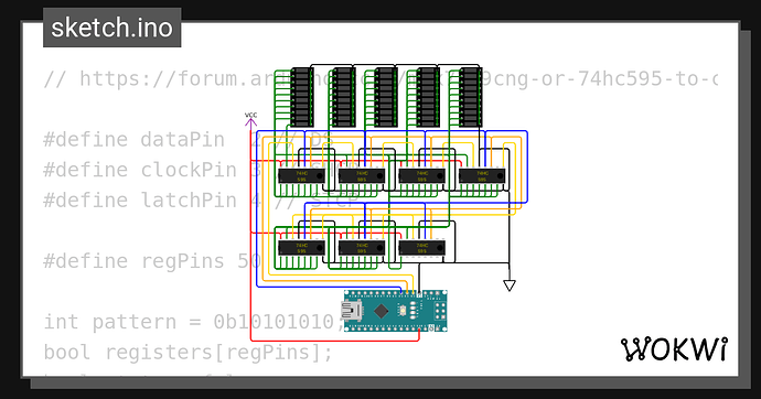

I was looking at shift registers before I found the MAX7219 chips. I not sure they'll do what I want since everything I've read says you can only chain 2 of them together giving only 8 output displays. I wonder if they make 16-bit shift registers? Maybe those would work?
My project is to make a baseball scoreboard where each of the innings is it's own seven segment display, along with Runs, Hits, Errors, Teams, etc. - meaning I'm looking at driving 30-40 individual seven segment displays.
This is my first hardware and low level coding project so I don't fully understand what I'm doing yet, but from what I can tell you can daisy chain the MAX7221 chips together, which would give me enough outputs to drive the displays.

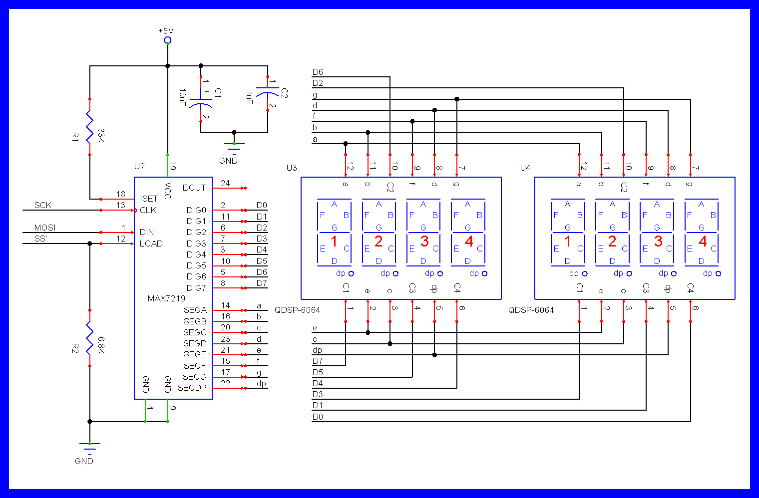

  • That's what the MAX7219 will do for you.
  • Example, here we are driving two 4-digit displays, total of eight 7-segment digits:
I can't see that limitation in the data sheet.
See figure 3, page 13 in the datasheet from post#2 for a 16 digit example. The practical limit is your ability to manage the data required for your displays.

Are you saying I can chain together as many SN74HC595N shift registers as I need? Do you know of any tutorials that show 3 or more registers chained together? Noob here and an example that I could follow would be great.
The tutorials I watched all showed just two SN74HC595N Registers and I didn’t see a way to add more (I can’t remember the specifics, sorry)
Five...
Thank you. Looks simple enough for me to follow
Yeth. As you can see in the rxample @xfpd provides, it is.
Look at the schematic of at any of those places you saw two being chained, and look at what accomplishes the connection between the two. I think it's as minimal as data out -> data in. All the other signals are parallel connections to the microprocessor. Since those are all inputs to the shift register, you can probably drive many more than quite a few.
To add a third, just use the same pins that were involved in connecting the first to the second, and so on.
The data spills off the last shift register, routed to no where. Probably the so-called bit bucket.
And the data in to the first in the chain is what the Arduino board sez.
And because they are just logic chips, you would probably be hard pressed to clock the whole thing too fast.

There is no limit on the MAX7219 regarding daisy chaining. Some libraries are limited.
But even with a limit of 8 MAX7219, you end up with 8 x 8 = 64 digits.
And the next 64 digits (with another 8 MAX7219) will only require one additional CS (Chip Select - Load) line.
