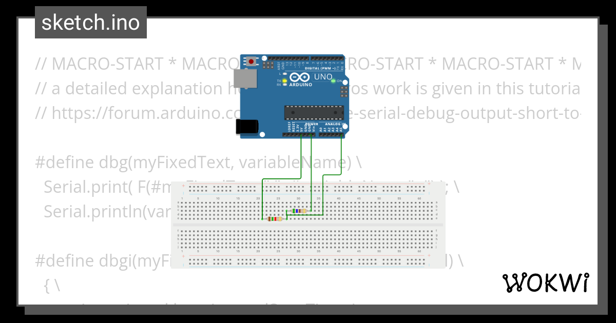

Hello friends,
I've now used the simulator, but it simply doesn't give me the correct voltage, only "INF". is this a bug or am I an idiot?
here ist the Link: Simulator ohmmeter problem

oh, ja, ist komisch mit dem speichern dort. Hier: https://wokwi.com/projects/388638572452156417

To analyse such an error print
each and every
variable
and
each and every
step of the calculation to the serial monitor
and then you will see where the bug is
I changed all variables to float. But the bug is stil there.
I guess you have to use millivolts instead of volts
No. probably the WOKWI-simulator is unable to calculate a voltage-divider build with two resistors
I replaced your resistors with a slide-potentiometer and now it works
