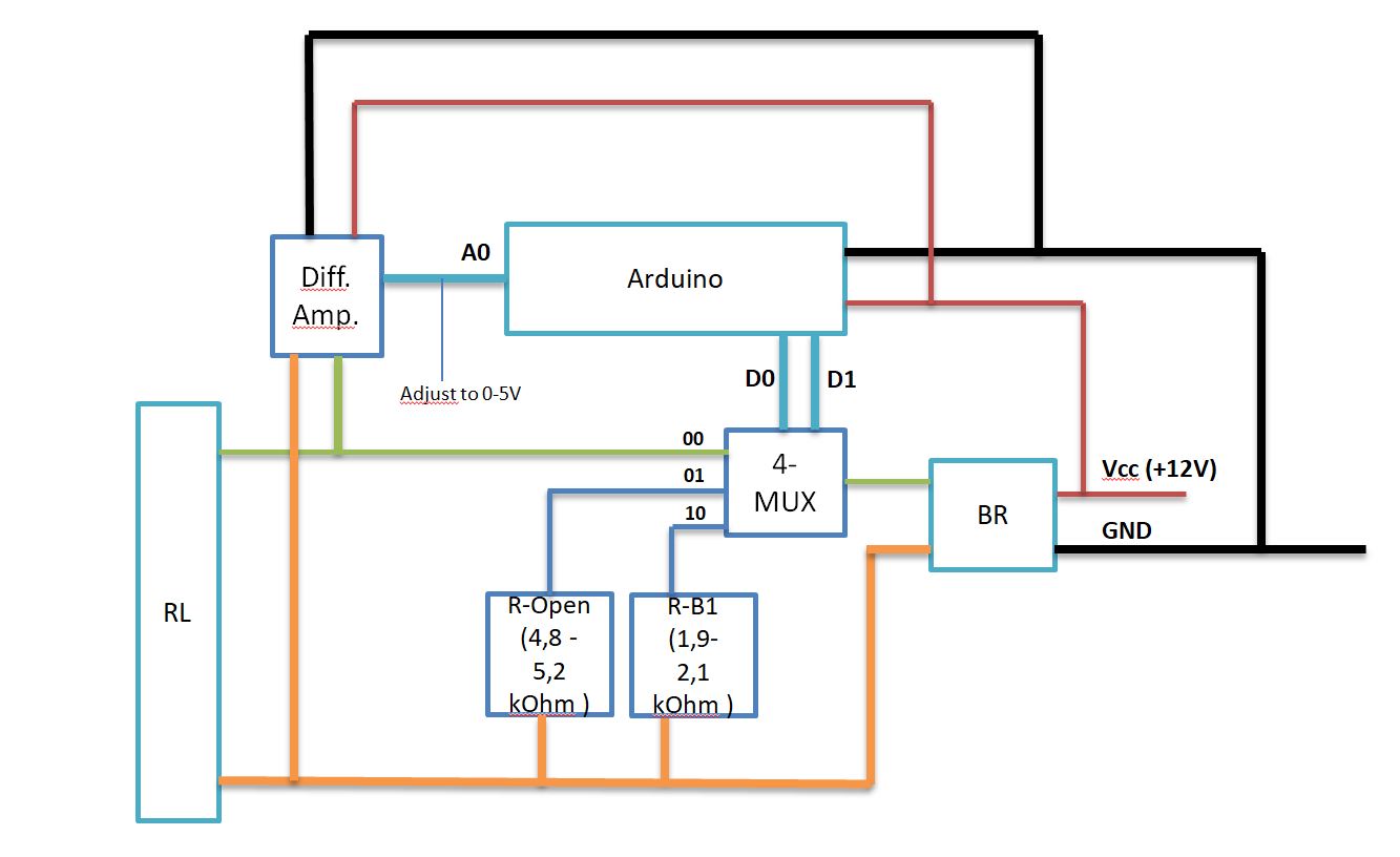

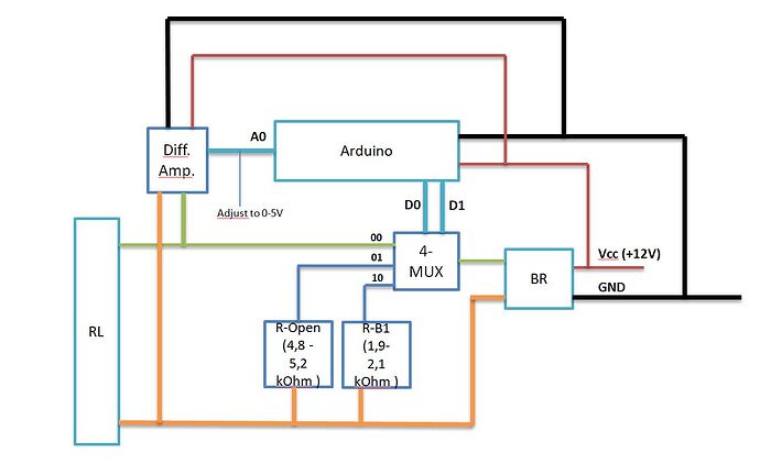

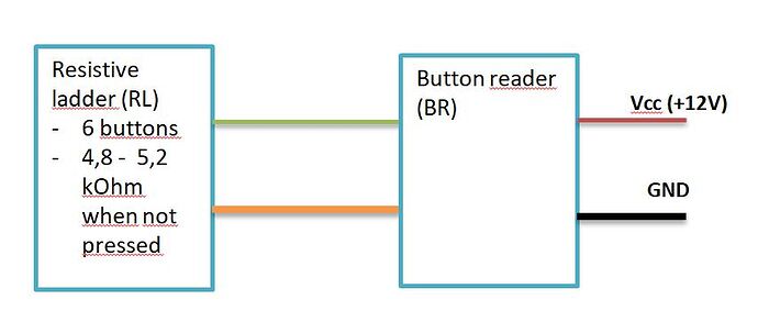

Hi everybody,
I have a resistive ladder (RL) with six buttons and a device (BR) that uses it.
I want to sit between them, with the following requirements:
  1. I don't want to make any assumptions about whether the second line is grounded or anything else about the BR.
  2. Under "normal" conditions, BR should not notice my presence.
  3. If I press a designated button (say B1) on the ladder for more than a fixed amount of time (say 2 seconds): i) BR must be 'disconnected' (as if no buttons are pressed); ii) BR must not detect the (long) press (i.e., BR must be disconnected while the press is ongoing and before it could detect the press).
  4. When I decide to, I will reconnect BR and allow the signals to pass through.
I have the following design in mind
  1. Use a Difference Amplifier to: i) Probe the signal without affecting what BR sees, and ii) Get the voltage even if a line is not grounded.
  2. Use this algorithm:
    i) Start with the MUX on the '00' channel.
    ii) If a button other than B1 is pressed, do nothing.
    iii) If button B1 is pressed, switch the MUX to the '01' channel and isolate BR (hoping to be fast enough to not trigger the device).
    iv) If button B1 is pressed for more than 2 seconds, stay on '01'.
    v) If button B1 is pressed for less than 2 seconds, switch the MUX to '10' for the duration B1 was pressed, then return to '00'.
I think that with this design there might be are a couple of pitfalls, especially with the timing to mask the B1 press.
At this point, any advice, improvements, or alternative (and better) solutions are welcome.
I considered fully isolating the two circuits and having the Arduino echoes what it detects on the input (perhaps with a digital potentiometer or a 'twin' resistive ladder), but that seems to me more fragile and less resilient, and it would require more assumptions (especially on BR).
Thank you!

Looks like it will fry your Arduino.
Can you draw out what sort of BR you are going to use please. There are a few ways you can implement a resistor ladder.

So post a link to the data sheet for this component or at least from where you bought it.
Your diagram as you present it has 12V going into the BR then it has two outputs coming out of the BR. The green wire coming out is going to a multiplexer. What do you think 12V is going to do to a Multiplexer? And what is the orange wire going to carry?
The big problem is that what you have posted is not a schematic, it is simply a confusing, ambiguous, block diagram, not a schematic at all.
  1. There are no proper component names.
  2. There are no power supply lines going to the components.
  3. There is no circuit for the differential amplifier, just a block.
  4. There seems to be no power supply decoupling capacitors in the circuit.
That will be a good trick because then the voltage will be floating, and you can't measure a floating voltage with an A/D converter.

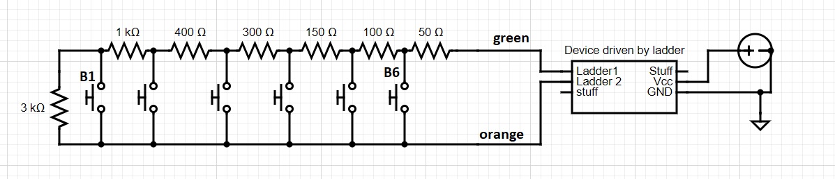

Hi Mike,
Thank you for your time.
My confusing block diagram was meant to discuss the concept (or any viable alternatives) before diving into details.

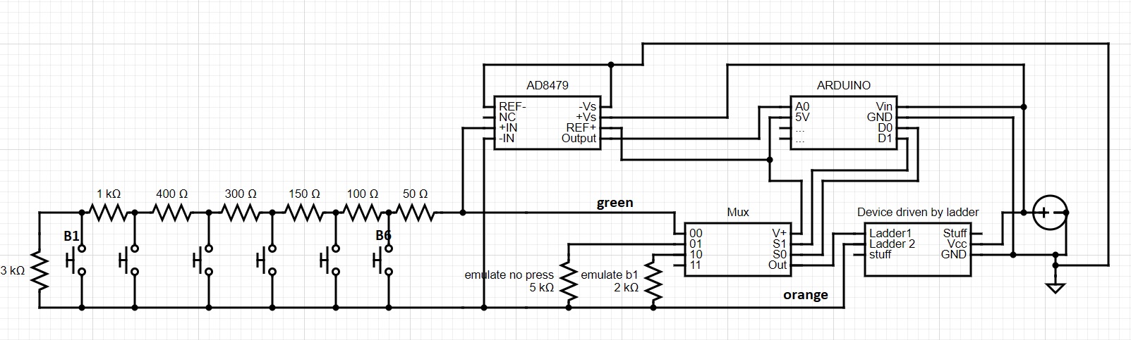

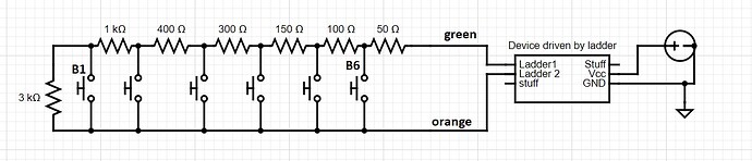

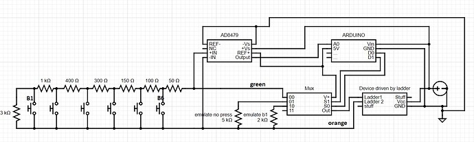

Here’s a simplified schematic (without capacitors, protection diodes, etc.).
I want to clarify a few points:
  1. RL and BR are simply off-the-shelf components designed to work together, connected together by two wires (green and orange lines, in my drawings). They could be, for example, buttons (RL) that move a point on a screen (BR).
  2. RL is definitely a resistive ladder, and I can easily figure out the resistance values with a multimeter.
  3. BR calculates the voltage between the green and orange lines, maybe with a simple voltage divider, or perhaps something more complex. I don’t want to reverse-engineer this by design, because I have to work with several BRs, and the solution should be resilient enough without needing further details on this aspect.
  4. BRs operate at 12V, and I plan to use the Arduino’s 5V to power the MUX and as a reference for the differential amplifier.
I too want to clarify a few points.
What are RL and RB?
Why are you keeping this a secrete?
Which is why I asked for the part number, or link to where you bought it. In other words what is the shelf they came from?
Normally in a resistor array all the resistors are of the same value with a common connection. Like the sort of thing you would use for multiple pull up resistors. Now in your diagram you have the resistors in the array all having different values, this is not normal. Is this part of RB and RL or are you making this ladder with your own parts? If so you need to sort out individual resistors to make sure they are accurate enough. Also those values are not very good to detect a button press, you would normally use an R/2R ladder.
The box on the right says "Device driven by ladder". It has two power inputs a Vcc of 12 V and a ground. But it also has a Ladder1 connection, which seems to be connected to the output from a multiplexer. So this is somehow feeding into that circuit. So I can't see what this is going to do, that is how it will interact with the device driven by ladder box. This box also has enigmatic "stuff" inputs an outputs labeled.
Also the AD8479 is somewhat overkill for what you are trying to do, Click here to download the data sheet for this part
Also I am not convinced you have the wiring correct as none of the components have any pin numbers associated with them.
The problem is you know that it means but we don't. You have these devices and we don't. So if you want to communicate your ideas with others you have to explain exactly what you have and not keep secretes.

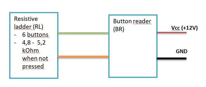

Here’s the situation:
I have a COTS device composed of:
i) a head unit (powered at 12V) and
ii) a wired remote control connected by two wires.
The remote control has been reverse-engineered (a big word to say that I looked inside and measured the resistances with a multimeter...) and it’s nothing more than a resistive ladder.
I want to create a device (based on Arduino) that I can place between the head unit (BR) and the remote (RL). This device should pass through the signals from RL to BR, until a certain event occurs (e.g., a long press on one of the remote's buttons). When that event happens, I want to isolate BR until another event occurs, after which I want to pass the signals through again.
So, I’d like to discuss the best solution to achieve this. I started with a solution I had in mind, but I’m completely open to changing my design. I’m here to gather feedback before diving into a proof of concept.

In my solution, the multiplexer serves as a way to select between three different states of the system:
00 - Pass through (nothing should change from schematic #1, from the BR point of view)
01 - Emulate no button press (ie., disconnect BR from RL)
10 - Emulate the press of a specific button Emulate the press of a specific button (this is needed in my algorithm to handle cases where the button - say B1 - isn’t pressed long enough, so I need to echo the press to BR).
Do you think the MUX will create a different impedance seen by BR or anything else that could interfere with how BR calculates the ladder resistance/voltage? I know the question might be difficult to answer without specific assumptions about how BR circuits work, but this is exactly the challenge I’m facing, as I have to deal with different BRs that may accomplish this task in different ways (though I suspect in 99% of cases, it will be a voltage divider with the second pin referenced to ground).

I think that with any opamp configured as differential amplifier (or not) you can just use one of the lines as GND reference, provided that the voltage range is inside the opamp rails.
But I don't understand where does the voltage come in the resistors ladder. Between green and orange you can measure resistance, not voltage:
Or do you apply a voltage in the other side?
Hi stonemk,
Thank you for your reply.
The device (BR) applies a voltage to the ladder and measures the resistance using something like a voltage divider to determine if and which button is pressed. I can easily read the voltage with a multimeter when BR is running.
Ok, then put a voltage divider to reduce the voltage range (if needed), use the lower side as GND reference and read the voltage of the other side with the MCU ADC.
On the other side maybe you don't need a resistor ladder, just put the same voltage than the device expects.
But you are not showing how the device apply a voltage to the resistor ladder. There should be another wire.
You can keep the same system, or replace/bypass it as well and apply your own voltage. But I don't know how is the setup.
