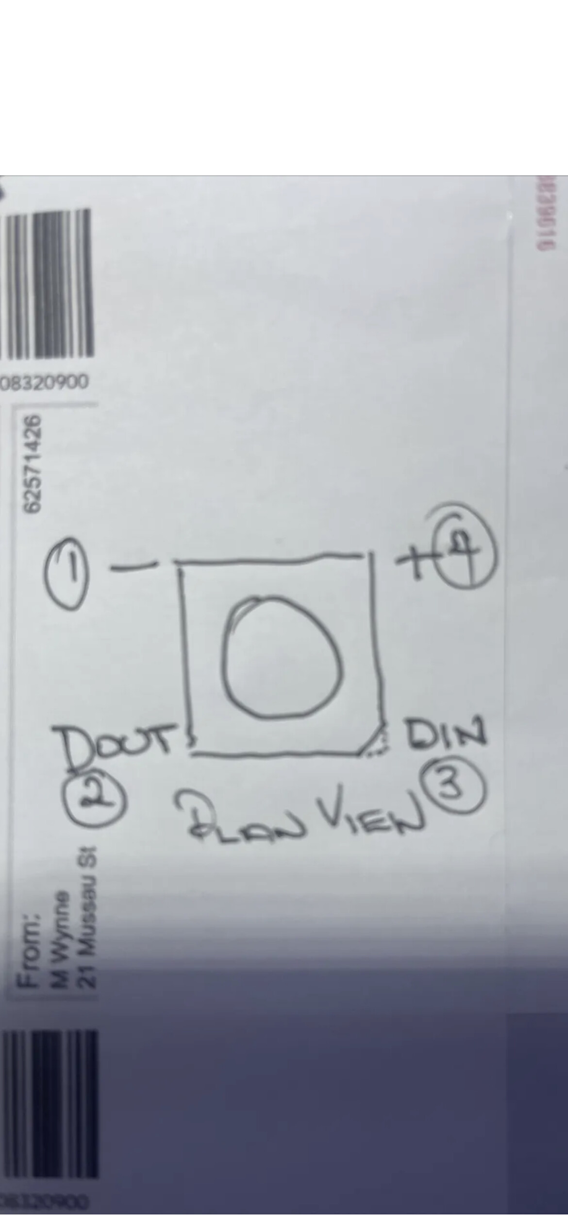

Before i was given the datasheet i looked at others and noticed most of the sheets of different brands had the champher on the ground side.

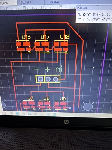

And this id the pcb i had made up

Can we have a schematic of your circuit please?
What ever CAD program you are using, you should be able to export an image in jpg, png or pdf.
The Export should be under the Files tab.

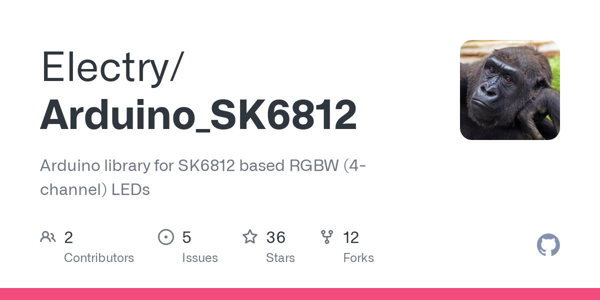

#include <SK6812.h>
#define NUM 2
SK6812 LED(NUM); // number of SK6812
RGBW color1 = {0, 0, 255, 50}; // 255 blue, 50 white
  LED.set_output(4); // Digital Pin 4
  LED.set_rgbw(0, color1); // Set first LED to color1
  LED.set_rgbw(1, {0, 0, 0, 255}); // Set second LED to white (using only W channel)
  LED.sync(); // Send the values to the LEDs
  LED.set_rgbw(1, {255, 255, 255, 0}); // Set second LED to white (using only RGB channels)
  LED.sync();
Actually it turns out the data sheet i was given had the wrong pin configuration. This is the correct one as confirmed by the seller who soldered wires to one to confirm. Ive never seen one layed out like that before.
