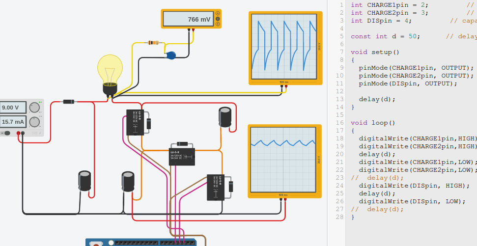

This is doing something as you can see on the oscilloscope. I use digitalWrite() and delay() to turn the pins off and on. Tinkercad has mosfets and optocouplers, but I wanted to test it with relays first. I did add the internal diodes of the mosfets.
The large capacitor on the left is 0.1F and the other two capacitors are 1000µF (that is 100 times smaller than the large capacitor).

I forgot to add a oscilloscope for the capacitor C1 in the previous picture. Here it is:
For a maximum energy put into the load, the surface area of the curve in the upper oscilloscope is important. If waiting for too long, not much energy is put into the load.
I tuned the delay for a good amount of energy that is put into the load. As you can see, the voltage of C1 is useless.
Therefor my idea is to measure the voltage on the right side of the load. Instead of calculating the surface, I think that calculating the slope of the curve is enough. At a certain volts-per-second the circuit can switch over to the other state. Different volts-per-seconds might be needed for both states.
Maybe measuring the current through the load is an alternative method. If the load is inductive or has a low resistance, then the current might be more accurate than the voltage on the right side of the load.
It also shows that it is not a "alternating" voltage for the load. There is a DC component, which is inherit to the circuit.

The voltage over the load through a RC filter shows the DC component:
The charging and discharging are both set to 50ms. I don't know what the influence of the relays is.
The Wokwi simulator adds a delay to the relays, just like relays in real life. I don't know about the relays in Tinkercad.
With the 50ms, the capacitors are not fully charged and not fully discharged.
When I look at the graph of the oscilloscope, then the average positive voltage is +3.2V (guessed) and the average negative voltage is -1.5V (guessed). The load gets an average of +1.7V. That is not near the 766mV of the Voltmeter, so something is not optimal.

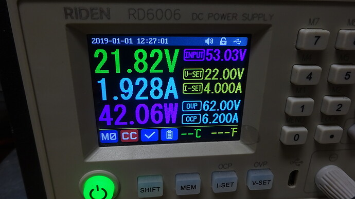

Unfortunately there is no such thing in a closed system, You asked what the benefits are well I was hoping for better efficiency, Here are some pics of the real waveform and input power, with it setup as a mains step up inverter, i cant tell you the power in the bulb because i don't have any equipment to measure it accurately but i tried to set the brightness as close as i could by eye compared to it being plugged into the mains
. The mosfets run surprisingly cool without a heatink, the most heat comes from the input diode.
