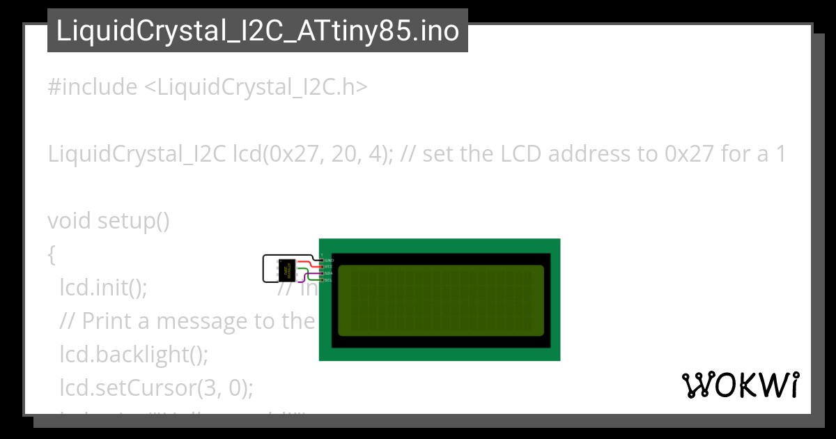

The problem is it is on a attiny85 and only 4 pins available. Not sure which lcd I can use being only 65% of the sketch memory is taking ip by the oled and thermistor. Which mostly of that taking up is by the oled itself.

if you are using OLED, use a MOSFET as a switch and turn it on only when you need to display something. The best thing is to cut the power altogether. The sleep mode of LCD controller ICs still consumes current as well as other sections in the LCD.
Here is one example of ATTIN85 driving a 16x2 LCD.
for best power performance, you have to find it via LCD suppliers themselves (if it is for a commercial project)
