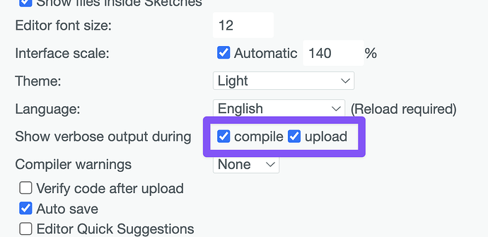

Hi to all,
why code uploading on my PC is slow and on the other PCs I tried is fast (5 seconds vs. less than 1 second)? My CPU is an AMD 5800H and I use the latest IDE 2.3. I also tested several cables
Are you using UNO R4?
WiFi or Minima?
There may be a number of reasons for slow uploads.
could you please enable verbose compile/upload and maybe try and see if the time is mostly spent on compiling?
Sometimes it can be a USB hub issue if you're using one

@the_marox666
3.2 seconds.
which part seems slower, the compile or the upload?
you may want to disable the verbose checkboxes one at a time and scope where the issue is.
Do you have a USB hub?
What about the other machines you've tested this on?
The upload, on an intel of 8 years ago the upload time is less tham a second
that seems a bit odd.
I suppose the old PC is running Arduino IDE 1.8.x
No the latest version, the 2 3. Compile time is little bit longer, but upload is immediate
