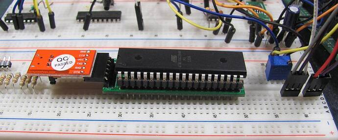

You can see that here on the '1284P derivative board that I offer with a FTDI Basic clone from tinyosshop.com
Cross Roads Electronics
