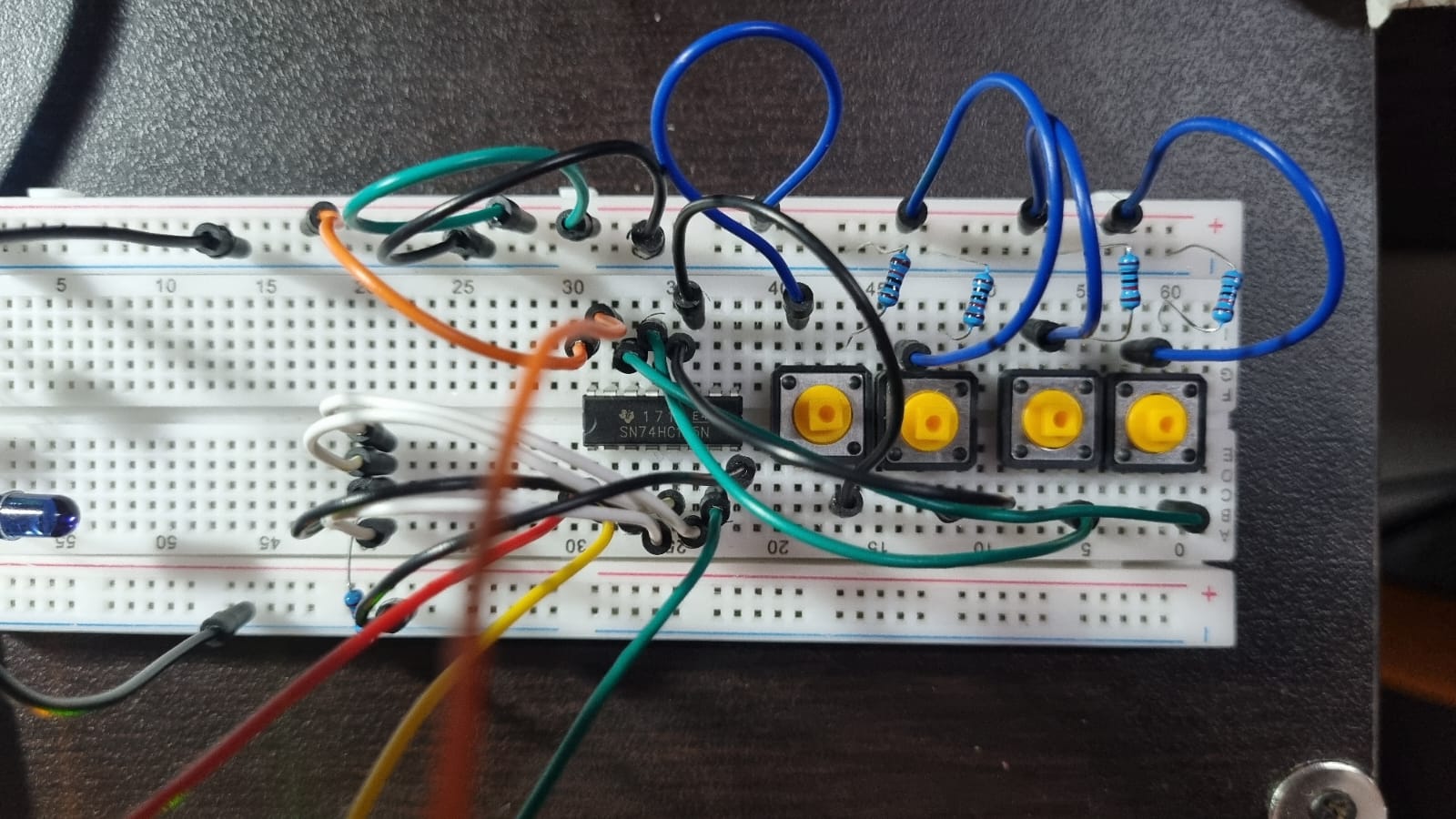

SN74HC165N not working
I am a newbie in Arduino , So while trying to increase the number of input , 74HC165 come out as a solution
But the problem is the SN74HC165 is always giving High output
One other thing I found out that on connecting Vcc to 5v , the D1 , D2 , D3 , D4 are automatically getting high

I later also tried by removing every button and just giving 5V to D1 and leaving other input as it is
Is applying a pull down resistor at every input is compulsory?
I actually didn't use any capacitor because I don't have , Could that be the problem?
Do you have a DMM, Digital Multi Meter?
Can you please post some images of you project?
So we can see your component layout.
You must apply either pull-up or pull-down resistors so that the input pins of the 74hc165 are not floating.
Yes, a 0.1uF ceramic bypass cap is required for each bare chip in a circuit. It should be connected to the Vcc and ground pins, close to the chip.
No , i don't have a DMM
Here I am attaching some image of my wiring
In D5, d6, d7 and d8 , I used a common 10k pull down resistor as I have only 5 of them
Also i did not used a 0.1uF capacitor
Thanks....
Okay but isn't the function of capacitor is to smooth the DC output ? I mean is it compulsory to put it here
Please correct me if I am wrong
@sn29jan I have read your post about the same issue but didn't see any Reply marked as Solution
I will be great to know that how do you solve that?

I also tried just by removing all the buttons and directly applying voltage individually to them. Still unable to figure it out
Also the set of buttons that i am using have made it easy to find same side of button
This is where a small inexpensive DMM would help.
Do the button pins reach and contact the protoboard sockets?
So how can i exactly use that to find problem in this case? can you please elaborate...
You can use the DMM to measure the voltages around your press buttons before and when you press the button.
You can then trace the changing voltage to the 165N IC to prove you have continuity.
Is this really what you want to do? You have effectively connected all four pins together now so setting any one of them will set all of them to the same value.
Output of what?
So at least these pins are now in PULL down condition , and I can check Inputs with buttons on remaining 4 inputs ...
