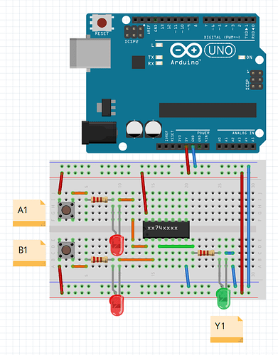

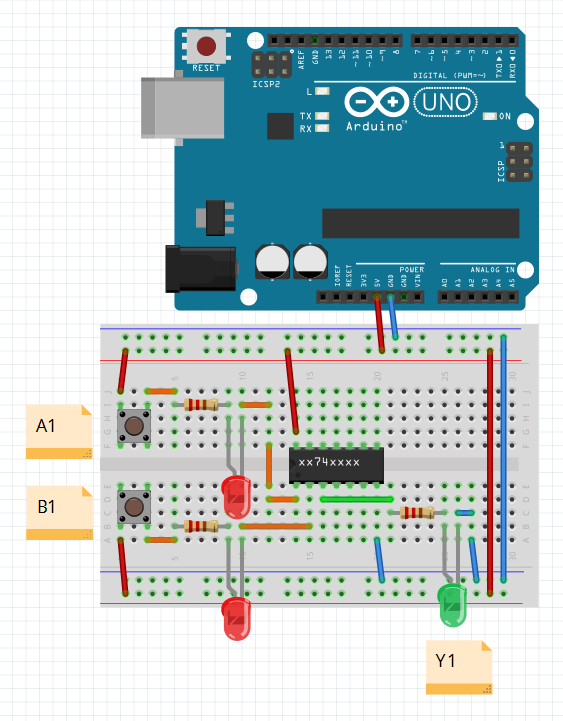

Sorry for many silly questions but for the last time here is a raw sketch of my demo circuit:
(I know, the pins are not always A1-B1-Y1, sometimes it's Y1-A1-B1 like NOR.)
Which IC-family (HC, ACT, something else) should I use in this case?
I need a NOT, AND, OR, NAND, NOR and XOR working stable.
The pinouts are the same for the same logic part across all families.
