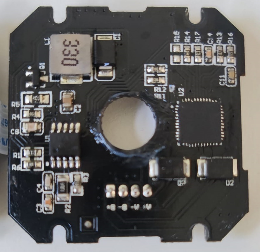

I have a snapmaker 3-in-1 Printer/Laser/CNC but recently they have changed the rails and I have 5 axis rails spare. I want to see if I can reuse them for other projects.
I have some experience with arduino and have different boards available.
i have created some pictures of the controller boards of the stepper motors.
I have also create an image of the connector.
1 - Yellow - EN
2 - Orange - STEP
3 - Green - CAN_H
4 - Black - GND
5 - Red - 24v
6 - White - DIR
7 - Purple - CAN_L
8 - Blue - NC
As far as I read on the internet the motors do use CANBUS.
Is there any sample code to start using the stepper motors?
I see there is a gd32f103 chip on one of the boards.
datasheet
Also see this chip VP230, this seems to be the CAN transceiver. datasheet
The stepper motor has a sticker with the value 42HD4428-32.
I found someone else looking for info in the snapmaker forum:
https://forum.snapmaker.com/t/anyone-have-technical-data/7965/5
Hopefully someone has some guides for me to get started with this.
Anyone have Technical Data? - #5 by khyeung - Snapmaker 2.0 - Snapmaker: where creation happens
The stepper signals (STP, DIR, EN…) go from the main controller directly to the stepper motor driver
Source: Anyone have Technical Data? - #5 by khyeung - Snapmaker 2.0 - Snapmaker: where creation happens
Maybe CAN communication is just an alternative.
