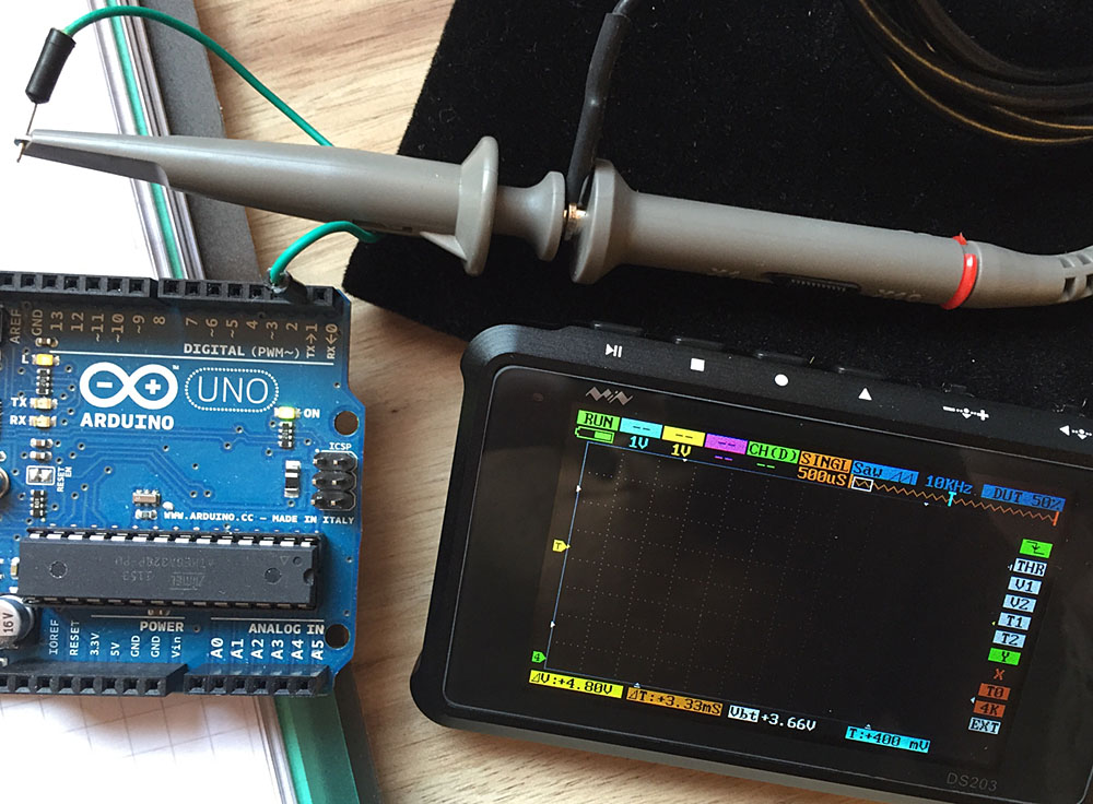

I ordered an DSO QUAD to learn a bit about scope usage and see my electrical experiments in wave forms for further analysis (I know that this is a toy... no comments about that please ;)).
I tried to sniff a serial message with the scope without any luck (actually tried what this guy did in his digital test: DSO Quad - Hosentaschenoszilloskop, I you do not speak German scroll to the middle of the page for a scope screenshot)
Yo can see my connections in the attached picture. Prope connected to TX, Pin 1
Im running this code on the Arduino:

My scope settings are:
Trigger: Falling Edge for Channel D
Trigger Mode: Single
Channel: (Digital) D
But my scope does not trigger at all as it does in the test from the link above.
Any ideas what Im doing wrong? I the DSO broken?

the ground of the probe is correctly connected to the ground of the arduino?
you are working with the D channel but it seems to be disabled "--" on the screen of the scope
the trig voltage is lower than 5v?

Its working now.
I feel silly now too: forgot the GND and trigger voltage (allthough I dont understand why the threshold level seems only adjustable for analog channel A+B)... :cold_sweat:
