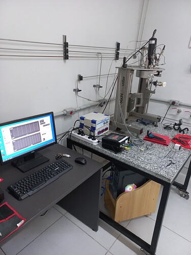

Hello guys.
I come here to present my software and firmware that I developed for my monograph. The system consists of acquiring data from an Arduino and the possibility of recording them in .TXT or .CSV files. The system can acquire signals from analog ports, interrupt port for speed counting if an encoder is inserted, control digital ports and other things.
The software was developed for industrial automation, focusing on the management of a pilot plant for the chemical industry, but as the probe inputs are renameable and the parameters can be changed, there are countless possibilities for use.
The software development was generated by the Processing platform
The system is entirely in English, and I have created a manual for use, there is also information on the connection diagram.
The available firmware is for recording on an Arduino Uno.
When starting the software, the Login and Password will be required, in the manual there is this information. Enter each information in the corresponding field and press enter, at the end, click on “OK”.

That's pretty cool :+1:
This is really neat! A nice low-cost alternative to doing it in LabVIEW/using NI devices. =)
