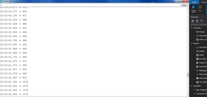

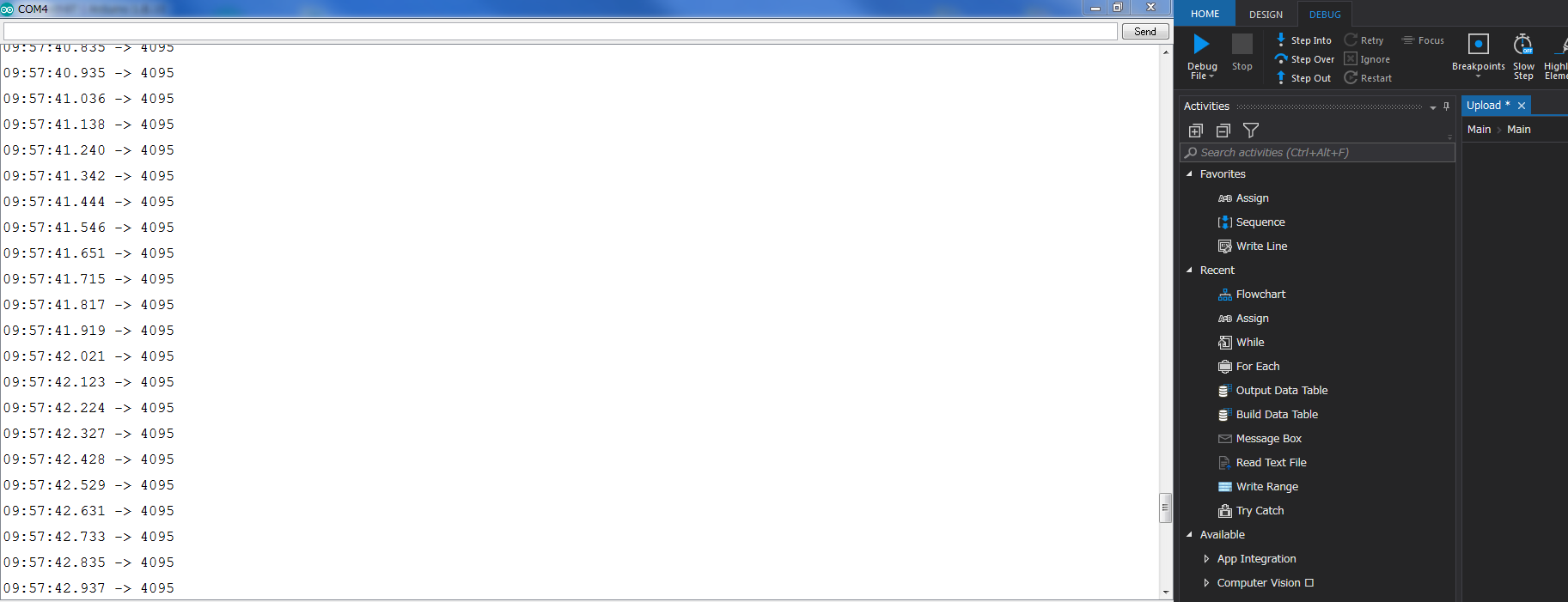

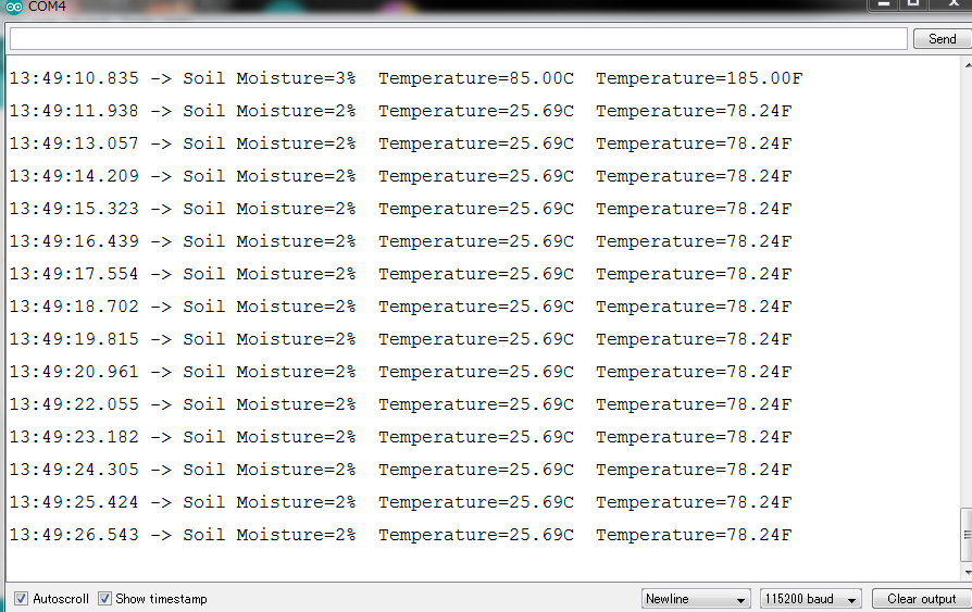

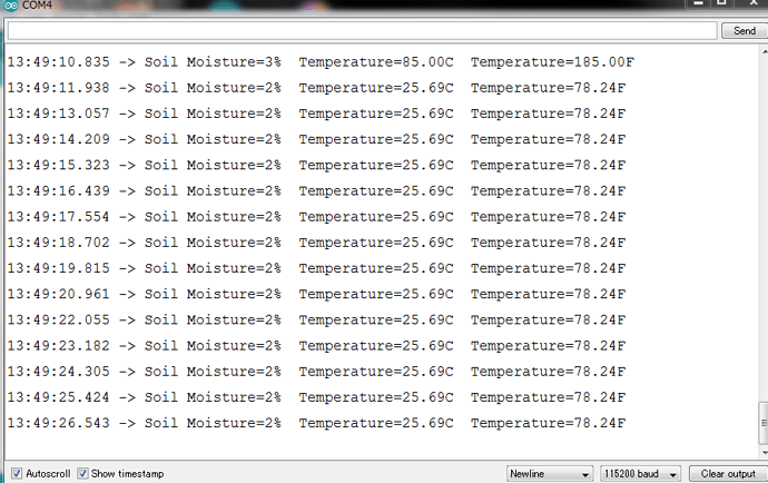

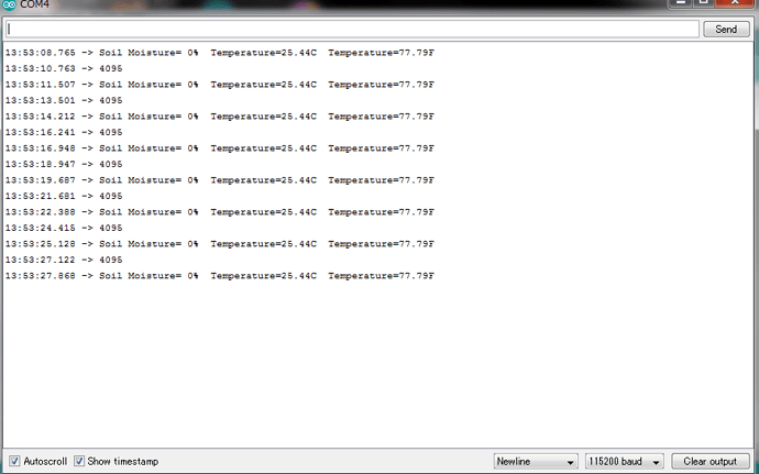

Hello Everyone, I am developing a smart farming system where I am using ESP32 Board and a Capacitive Soil Moisture sensor v1.2 in order to get Soil moisture data and send the it to a Raspberry Pi 3 via Bluetooth Low Energy (BLE). I am able to get other data from other sensors like temperature and humidity sensors and successfully send them to RPi3 through BLE technology. However, whenever I try to run the Soil Moisture moisture sensor together with the BLE I get a constant value of 0%. As I try to investigate the issue, using the code for Soil Moisture by itself the code works smoothly however, whenever I add the line SerialBT.begin("ESP32test") the result will be 0%. I am using ESP32-WROOM-32 and attached here are my codes and the outputs. Thank you in advance guys!
This is the snipped code for the Soil Moisture Sensor with BLE integrated where I think limits the sensor to get a right value:
SerialBT.begin("ESP32test"); //Bluetooth syntax to run BLE which i think is the problem
Serial.println("The device started, now you can pair it with bluetooth!");
Is there any way that I can run The BLE without compensating the data from the Capacitive Soil Moisture Sensor guys? I would be glad and willing to try your innovative ideas! Thank you very much!

Your soil moisture sensor ADC range is about 0.15V (for 0% to 100%, 0.72V - 0.87V). The low energy sent by the BLE device might be enough to change an input voltage in about that range if signal wires are not shielded completely. I guess this is a hardware problem.

According to the DFRobots website the voltage range from 0% to 100% must be much wider (about 1.3V). That's about 10 times your values. Are you completely sure you did the calibration correctly? Can you do the calibration again with BLE enabled?
Upon calibrating it again, i just arrived with the same result. I did the calibration with BLE but it just give me a constant output for the soil moisture sensor. I don't know what's the source of the issue. I would be glad to try your other suggestions.

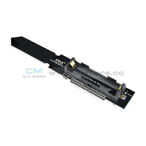

I had a similar requirement and instead of connecting things separately, I bought the integrated solutions like these:
ESP32 + DHT12 Soil Moisture & Temp & Humidity & USB-C
Or you could opt for this one which is based on ESP8266
Both of them have battery holders and necessary battery circuit so you could operate it remotely with no wires nothing.

The 1st link is based on ESP32 and has everything integrated temperature, soil moisture and humidity and also has battery connectors in case you want everything to be portable. I think a big powerbank connected to its USB Type C port would make it run longer.
The best way would obviously be plugging it into a USB wall brick.
The ESP32 has both WiFi and BLE, so you could just plug that board in via USB-C and upload a new software program to use BLE, rest everything (sensing soil temperature, moisture and interfacing with ESP32) would be taken care of since it is an integrated all in 1 solution.

I already had the system running using the suggested ESP32 SoC (System on Chip) of Benja. On this case there again exists another issue. Before I upload the code in the device, the device works well using the battery itself as a source of power. However, whenever I do upload my code it seems that the ESP32 SoC's stand alone power is broken and won't turn on again using the battery itself.
Is this a known issue?
I tried to investigate it using 5 other ESP32 SoCs and unfortunately, the same problem occurred. I am not sure if it is because of the GPIO assignments that causes the device to be broken or some other problem concerning short circuit inside the device.
If someone would be kind to provide me a data sheet of this device it would be a great help. Attached here is my code and below is the link of the ESP32 SoC that I'm using. Thank you very much.
