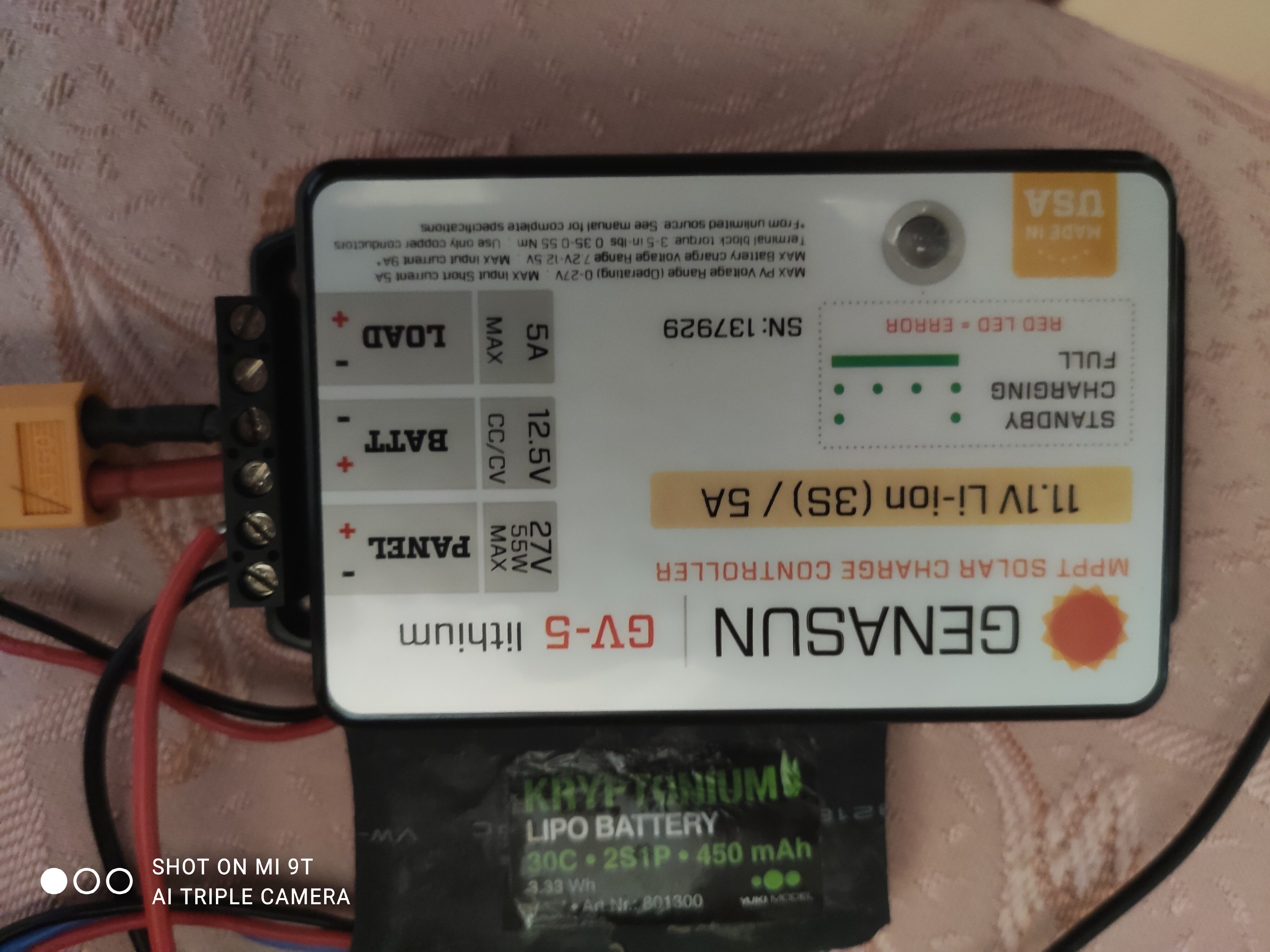

I have a small project to make a solar charging system for my 3S Li-Po battery (2500mAh). I bought the Genasun GV-5 lithium MPPT for this. However, when I connect the MPPT to the solar panel and the battery, I realized the Li-Po battery is not charging. Is there any problem with the connection? Thank you.

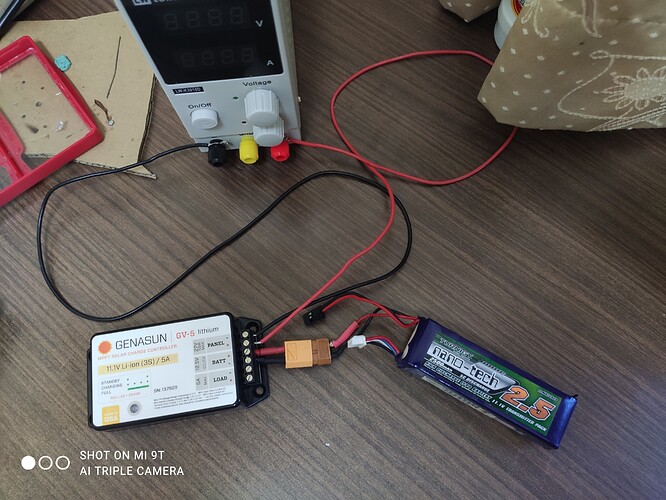

I set my power supply to be 4V and 0.5A
But the MPPT is brand new and the indication light on it shows me it's now "standby" when I connect the battery to it.
it should be enough.
but i see on picture 2S Li-Po

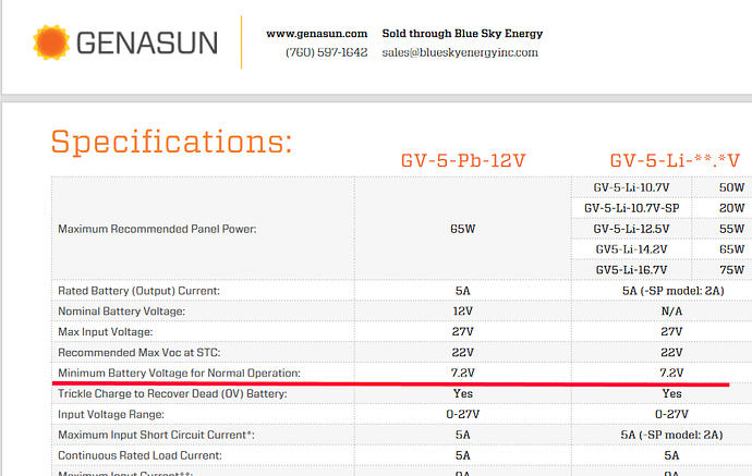

if your battery is discharged under 7.2V it is under minimum requiring
Why are you charging a 2S LiPo with a 3S charger, the battery will likely explode !!!!!

Oh no. Pls Ignore the 2S battery :sweat_smile:
Ya I already checked the voltage and it's above 7.2V. This is my connection.

on picture in post #13 is 3s li-Po battery.
charger is for 3S li-Ion, also near to similar CC-CV charge process.
but if battery is full why should it be charged, the system goes standby
