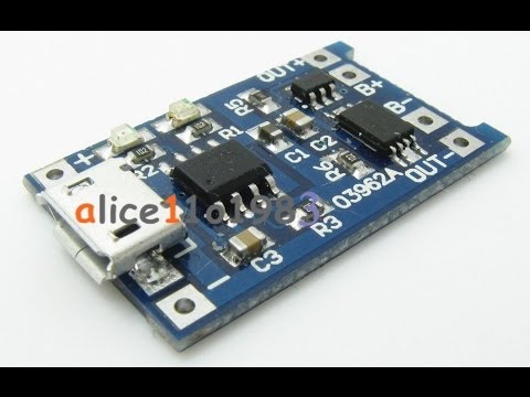

Does anyone here have experience on using a small solar panel to charge a 3.7v LiPo thru the typical TP4051 charger? Either using the popular ebay board, or a wemos Battery shield.
I have some devices (Wemos Mini mostly) which are into DeepSleep for 10min and only wake up for 10 seconds to transmit the readings, so basically the discharge rate is minimal. I have them chargind with variated small solar panels, which I had bought some time ago, different models, and Im not getting a decent charge rate, I need 100% sun (not on an overcast day) and it only charges during 2 or 3 hours during the day
I was wondering, maybe these chargers, that come preconfigured with the 1Ah charge rate (jumper in the jp1) need to be modified with the according charge resistor to rduce the charge rate to something closer to the solar panel capabilities, maybe if the charger is trying to pull 1A and the solar panel is providing 300mAh, the voltage is getting so low it doesn't stand

My issues is more related to the solar panel itself and their behaviour "under the sun". I have one small (maybe 10x10cm) solar panel that lights up the red charging led in the TP board, but the battery voltage (monitored thru Analog in in my Wemos board) isn't rising while the led shows "charging".
Then I switch to an oversize (for this project) solan panel, maybe (20x20cm) and the charging light turns on again BUT I DO see the battery voltage rising up.
Sorry I don't have the specs for these panels (I bought them a long time ago and there are no markings) but I wouldn't expect to be needed a 20x20 panel for such a small battery, Im just suspecting the smaller is 5V and it needs 100% direct sun straight into the panel, and maybe the larger one is 6V and just an overcast day is enough to get something close to 5v to activate the charging function, what do you think?

I just measured them under direct sunlight:
Small one: Open output 8V, short circuit 140mA
Large one: Open output: 7,3v, short circuit 500mA
Hidden from the direct sun but under undirect light they still provide
Small one: Open output 6,3V, short circuit 6mA
Large one: Open output: 5,8v, short circuit 20mA
Small is marked only "Sunwalk 001 110x110mm ROSH"
Large is marked "Starsolar CNC 165x165-6"

The voltages and amps were shown in my last comment, from what I see both panels should be fine but I may have to add the charging "PROG" resistor to lower the A so the voltage while charging on overcast sky doesn't drop that much

My solar panel provides: Small=145mAh Large=500mAh. Small would charge under the sun in 1.5h (which I get here these days), and large would charge fully in 30 mins. Both would do
Then I still think the voltage on the smaller one is dropping due to the total A pulling from the TP4056, under the required minimum voltage so it's not really charging, despite the red led is lit for 8h/day
