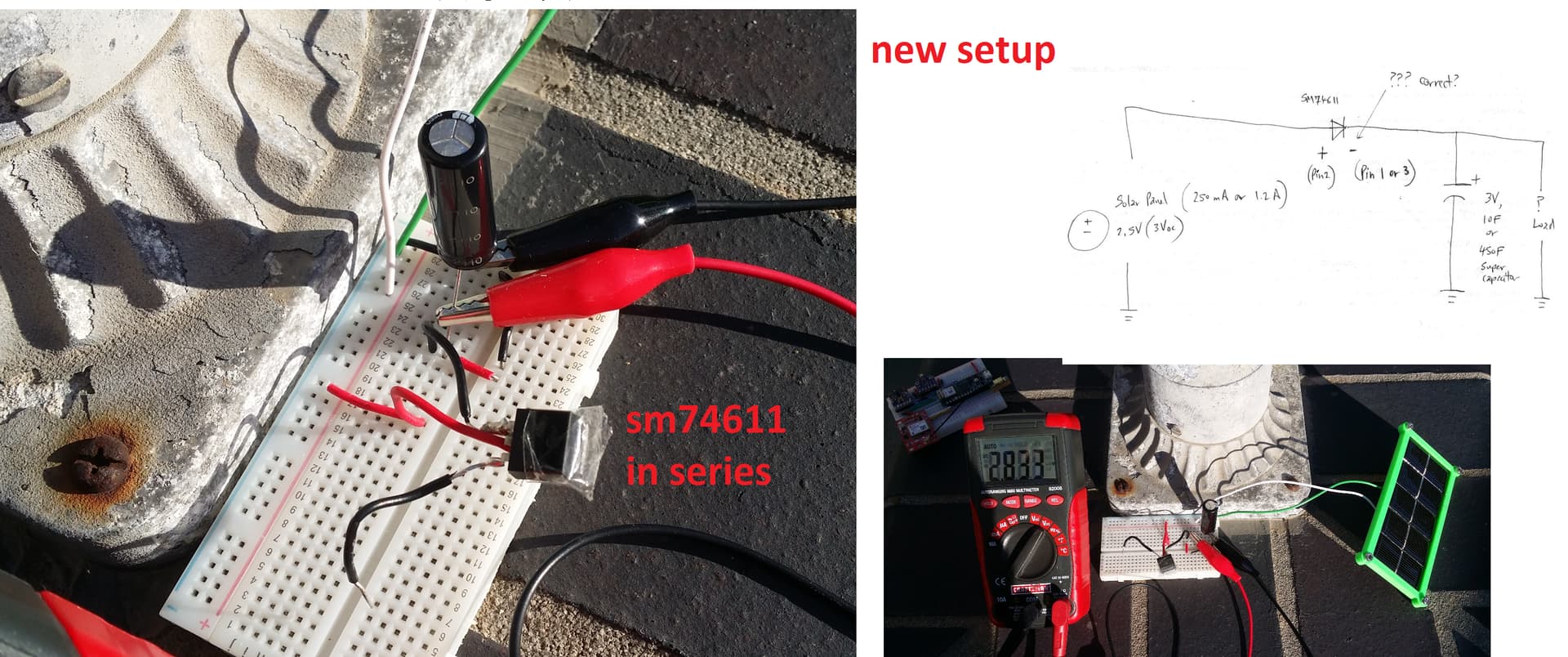

Just to give an overview of where I was before and now:
The diode was wired in parallel like a bypass diode and as soon as panel is shaded/dark, voltage dropped rapidly with no load on super capacitor.
After wiring it in series like a blocking diode, it doesn't not charge the panel at all. Current leakage of the super capacitor is all I see happening with no load connected at all.

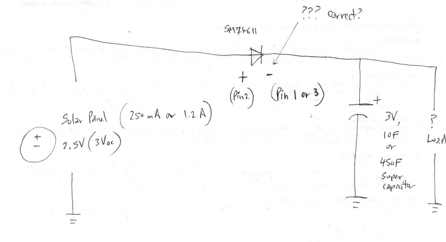

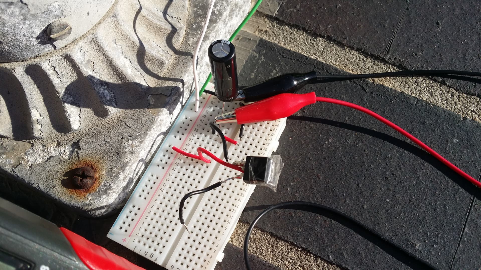

Here are schematics and pictures of the bread board setup for reference.

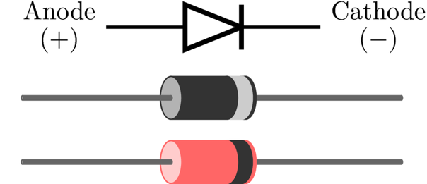

Yes. why do you want to do that?
I don't know, but the Cathode is the end where the current is allowed to flow out of a diode.
And that would be pin 2 or DAP.
It also says in the datasheet that pin 1 and 3 must be connected together for proper operation.
The diode actually looks pretty cool. But it doesnt provide any data for when voltage is below 5V. The footprint is pretty hefty, though. I will probably us a LM66100 for my design.
Wow! Thanks. I thought I was messing something up with the polarity.
I just rewired with the two black leads coming from pins 1 and 3 (anode) to come from the positive terminal of the solar panel, and the red lead coming from pin 2 (cathode) goes to the positive side of the super capacitor.
It's night time here right now, but after placing my hand on the panel there is no more voltage drop on the super capacitor. Will try during day time to see if light is successful in charging it.
