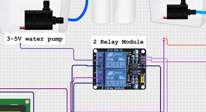

Will this power set-up work for a water filtration powered by arduino including 2 water pump, turbidity sensor and pH sensors?
We plan to have a 6V 750 mA Solar panel, TP4056 Lithium Battery Charger, 3.7 Li-on Rechargeable Battry, LM2596 DC-DC buck converter

Hi, @zie_e
Welcome to the forum.
We need more information, like what are the power requirements of the pumps.
A full schematic of your envisioned project would be welcome.
Can you please tell us your electronics, programming, arduino, hardware experience?
Thanks.. Tom.... :smiley: :+1: :coffee: :australia:
Likely not.
You don't tell any specs of your components, but I don't know any arduino board that could be reliably powered with this setup.
Battery has nominal voltage 3.7V, I would expect to get ~2.4V out from LM2596 at max.
what both @TomGeorge and @kmin have expressed here, We need more information and Likely not is true. Photovoltaic panels is a difficult power source to rely upon without calculations and evaluation of the site. To mention an example; that 750 mA spec would be under perfect conditions, always sunny, tracking the sun etc. Which is far from reality.
Regarding information needed, you haven't said anything about runtime for the pumps or how much A they require. The pumps (despite being the machinery to keep boats from sinking) is what likely will sink this project at current state. Sink and current in same sentence, that's a joke right there.
Do some research even here on the forum. You are missing components.
consider the merits of telling us what the module on the bottom left is, and what the module below the solar panel is. in the immortal words - actually, word- of Johnny 5, "INPUT!"

Please don't edit your original post when you add information, it's making the whole topic very confusing.
So, nothing has changed for the first issue here, you can't do what you are looking for with buck converter. Buck is stepping down voltage, but your arduino needs to have >6.5V on the VIN (or 5V on 5V pin).
Think with your team, how that could be resolved.
Hi, @zie_e
Why are you using the normally closed contacts for the pumps?
What is the purple and orange wires doing?
What about the ALL pump electrical connections?
PLEASE get out a pen(cil) and paper ad draw a decent schematic.
This kind of project has been done dozens or hundreds of times. Use google to search. Using google in a smart way means many searches with different search arguments. sometimes one search word spells the difference between success and failure.
Another way to tackle this is to break the one big project into several smaller projects. For example
  1. Solar charger
  2. Sensors (turbidity and pH)
  3. Pumps
    Once each sub-project is working, merge it into the single sketch. There is a tutorial on the forum that shows you how to merge.
Which tutorials?
Show links.
