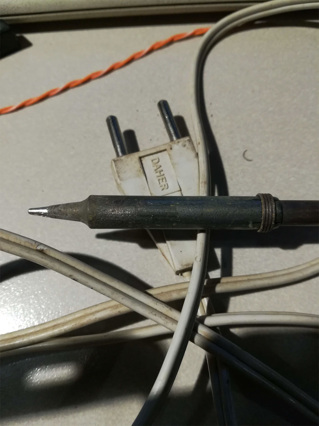

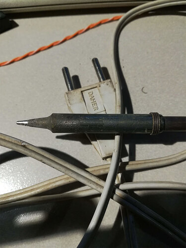

My 1st iron, back in 1988 was 220V job with a hood handle, without any kind of regulation it heated like crazy, the point was a cooper(ish) cylinder about 3 or 4mm thick without any kind of coating, that I had to file almost every day because it become pitted and corroded after a few hours of use.
Maybe the electronic solder (as it was called here) back then had acid flux inside instead of rosin or maybe it was just the heat...
I only used it for about 3 months, when I was able to buy a much better one that I still have today.
But in a fix, it would do the job, but you risk the pads and traces specially when trying to remove a component.

At the time that 'new' tips were called 'long duration' and here (in Portugal) were only available (for the public, it could have been different in the pro market) in fancy brands like JBC. All the cheaper irons just had the cooper rod.
The one I still have is only marked DAHER 30W 220V, the original box is gone, but I am quite sure that I bought it as being a JBC (I can't find any info about but the tips do look like the JBCs, with that small spring on the top), the tip is not the original because I changed it to a smaller one in the 90's but it is still very very shiny.
