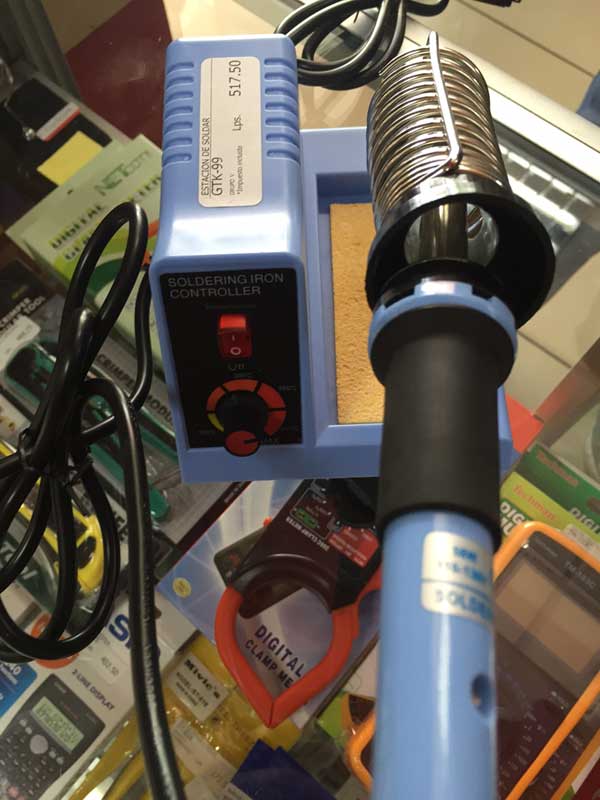

I had a small truper 60W soldering iron which I liked because it had a fine tip but today it stopped working. I plug it in and it simply wont heat up at all. Its all glued up rubber so opening it up doesnt seem like an option.
These are some locally available ones and I was wondering if anyone had ever heard of any of these:
There is a 25W, but Ive read 25W is too low to get a good solder melted?
There are a couple where one is 40W and another is 60W.
Then there is the one with the holder which is regulated.

I like Weller soldering irons. I would go with something like your 3rd picture.
I too like weller but they are expensive.
I would suggest a 50 to 60 W temp controlled iron.
There are some good ones available from china these days , just make sure though that spare tips will be available in future.
Not a problem with weller but i have had some fairly expensive irons in the past now useless from lack of replacement bits.
If you get a cheap one make sure you order the bits at the same time.
Got it! These are all chinese, its hard to get known brands down here. But one of those chinese ones is probably made at the weller factory in China :slight_smile:
Anyway, Ill get the last one because its temperature controlled (plus tips) and has that nice holder (burnt my fingers a few times already) and Ill get a FT for my lenk which has held out for a while on me. I just stopped using it because I didnt have the FT for it.
Thx guys

No I didnt like the truper that burnt out. It didnt have a guard like my lenk 40. It did come with tips, but I can get tips for the lenk as well. So no, I wouldnt want to replace its heating element.
That last one is a piece of junk. Our makerspace had 6 of them, they all fell apart. Get something with an actual variable temperature control. That one is merely a lamp dimmer in a holder.
Yes, it does need to be calibrated in degrees. Either Farenheit or Celcius, your choice.
With an iron that can go down to low temperatures, like 100-200C, you can do lots more things like modifying plastic boxes.
I think all of those irons are crap. First three aren't temp controlled, last one doesn't look like it has real temp control, just "hot, hotter, hottest" (in other words, it probably doesn't have feedback).
I would buy an old, used weller on eBay (or get one via other means) - get one of the ones with the icky greenish-blue case (the ones after they switched to other colors of case suck - I think they were bought out around then). The magnetic temperature control ones, you'll be passing on to your kids (though the ones with a dial instead of the magnet tips are more convenient). I have three weller irons that I use - and I'm pretty sure every one of them is significantly older than I am, and all work flawlessly.
Tips for Weller irons are still available and produced. We got some just a couple of months ago after getting a pair of super sexy 80W digitally temp controlled units - looks like the last generation of Weller irons before they stopped making good equipment.
25W irons aren't really enough, at least for any sort of serious work. You want 50W - and you MUST have some means of temp control for anything that touches a PCB. You're on here a lot - I'm sure you've seen the weekly "why can't I solder for shit" posts, where people post photos of boards that look like he reworked them with a firebreathing dragon, because they used a shitty non-temp-controlled iron that got too hot, overheated the flux (so it all smokes off before it does it's job), and lifted the traces. I think EVERY "why can't I solder" thread I've seen with pictures had damage that could only be inflicted by an overheated iron shown in the pictures, with one exception (the guy who put solder on the iron, waited for it to stop smoking, and then wondered why it wouldn't wet anything. I think his iron was too hot too, though). You want temp control, set to ~700F for most work.
