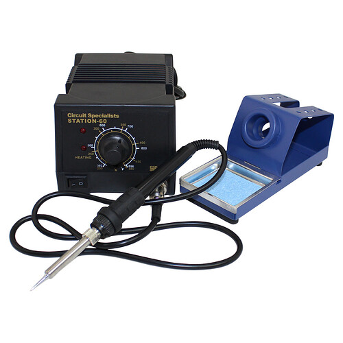

Circuit Specialists 60w Soldering Station
|500x500 Power Consumption: 60 W max VAC Input:110/120VAC Output Voltage to Soldering Iron: 24VAC Temperature Range: 200° C to 480° C / 392° F to 896° F Cord Assembly: 3 ft Heating element: Dual Core ceramic

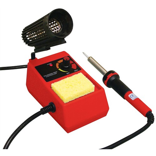

Elenco SL-75 Temperature Controlled Soldering Station • Low-cost solder station with manual temperature settings • 48W heater power • Temperature range: 350°F - 900°F • Electronics temperature control • Power on LED

I've been using one of these for a few years now -- very similar to the second one you show, but with a temperature display. I've been happy with it, although the display isn't really necessary.
If you hunt around a little, you might be able to find one that comes with a spare soldering iron. It may cost a few more dollars, but will give you peace of mind in case one fails (I've not had one fail yet).
The big advantage of these stations is that they heat up fast, so you can turn the temp. down when not in use and quickly return them to temp. when you need them again. If you're like me, you'll end up using just two temperatures: one you decide works best for soldering, and another for idle times.

The last two are garbage. They are just a lamp dimmer (phase control PWM) with no temperature feedback.
Just because an iron is labeled in degrees, does not mean it has feedback. Just because it says "adjustable temperature", does not mean it has feedback.
The Circuit Specialist iron says "A front panel led will blink while the system is heating and then once the set temperature has been acquired, it will stop blinking and stay on." That indicates temperature feedback.

So the circuit specialist would be the best option of the 4 in the OP?
