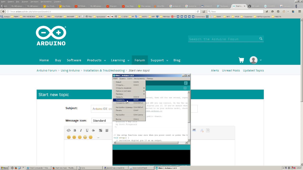

Arduino IDE crashed on "Save As..." on "Save" and "Open" (win XP)

You might get more information on the cause by running arduino_debug.exe (which is found in the Arduino IDE installation folder) from the command line, then examining the output after the crash. Please copy and paste the output here using code tags (</> button on the toolbar).
E:\My_Sunduk\Zhelezo\_soft\ARDUINO\arduino-1.6.9>arduino_debug.exe

# A fatal error has been detected by the Java Runtime Environment:
# EXCEPTION_ACCESS_VIOLATION (0xc0000005) at pc=0x261c0daf, pid=4488, tid=808
# JRE version: Java(TM) SE Runtime Environment (8.0_66-b17) (build 1.8.0_66-b17)
# Java VM: Java HotSpot(TM) Client VM (25.66-b17 mixed mode windows-x86 )
# Problematic frame:
# C [COMDLG32.dll+0x30daf]

A low memory dump is enabled and the minidump folder contains some information in itself
Hi all
Task solved
The problem was in patch open-save dialog box.
(I wanted to always have a "detailed view" and apply the DLL patcher program "FileOpenPatcher")
After restored button in this programm, arduino ide normal work.
