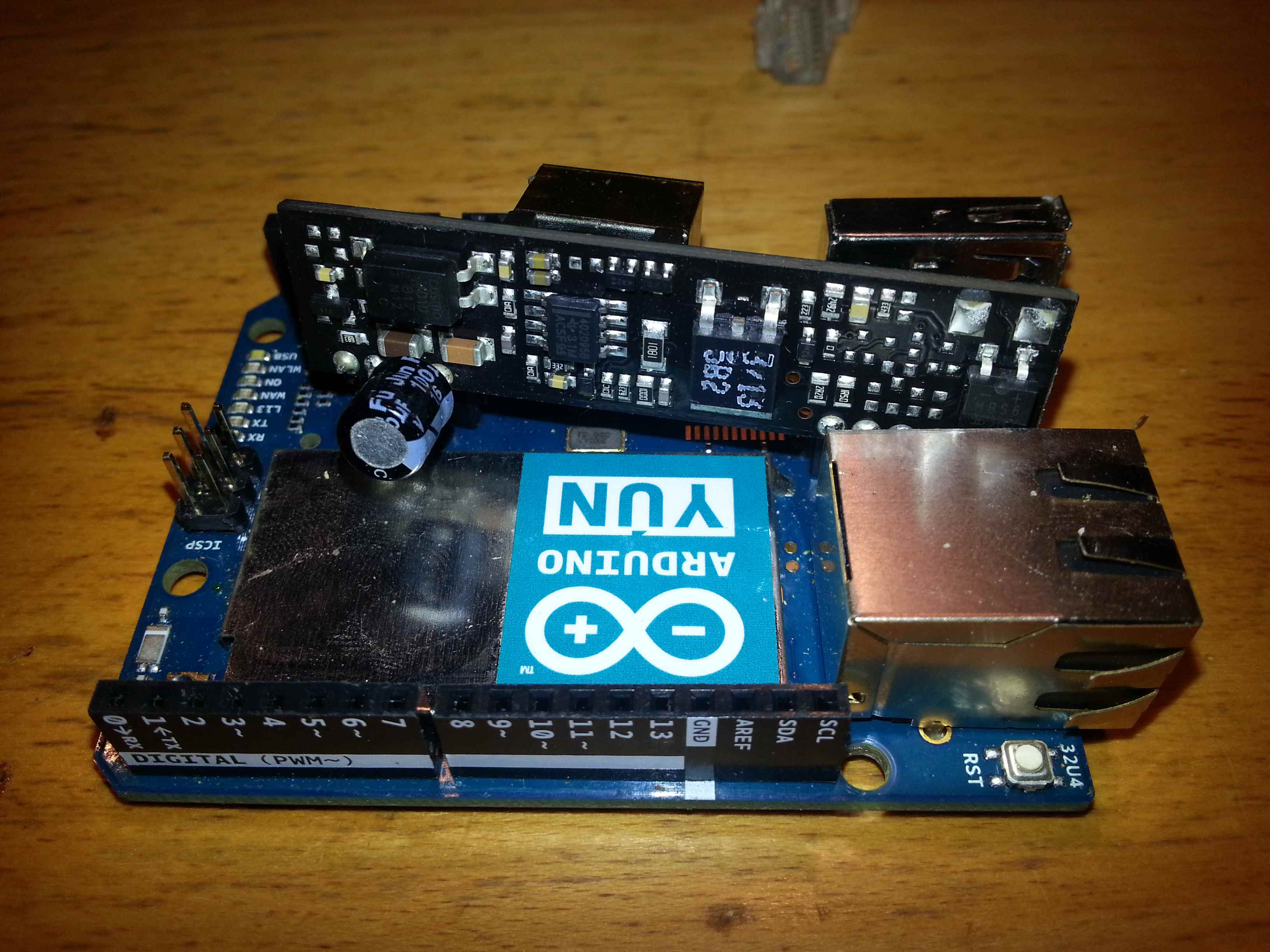

Hello,
I just soldered a brand new PoE module onto my Yun. (bought on arduino.cc). When i connect my Yun onto my PoE+ switch a strange sound is generated from the PoE module. The Yun is getting power over the ethernet cable. But that noise can't be normal?
I've made a short video that captured the sound:
It's annoying... Why is it doing that? An other PoE injector did not solve this. So it must be something with the PoE module.
All pins are soldered correctly. And the ethernet shield is not touching any pins on the PoE board.
My other Arduino board (EtherDue) with PoE does not make this noise...
Can i do something to resolve / reduce this sound issue?

There's a lot of static in the recording, which makes it hard to hear, but there seems to be a very high frequency whistle that stops as soon as you unplug the cable. I assume this is what you're hearing?
To me, that sounds like the switching power supply. Usually, the frequency is high enough to be inaudible. When it's that that pronounced, I find that it's often an overload condition where the supply is straining to provide enough power. What is the output current rating of the module?
In rare cases, I've seen where a bad transformer has loose windings that vibrate at the switching frequency, but most of the time it seems to be an overload.

Hi, Im An engineer from Silvertel
This whistle is the PoE modules DC-DC converter running unstable caused by lack of output capacitor.
We have already informed Arduino that they have not followed our datasheet; by not fitting an electrolytic capacitor across the PoE modules output pins.
In the Ag9600 datasheet, we specify using a 470uF electrolytic capacitor directly across the output pins. Here is a link to our datasheet, see Section 5.7 - http://www.silvertel.com/images/datasheets/Ag9600-datasheet-isolated-Power-over-Ethernet-PoE-module-solution.pdf
We have conducted tests for other Yun user and have worked out that you should be able to get away with fitting a 100uF 6.3V tantalum across the Ag9605-2BR output. Because Arduino haven’t made any provision on their Yun board for fitting an output capacitor, it has to be soldered directly across the pins (negative to pin 7 and positive to pin 8 ).
Attached is a photo showing the position of the capacitor on the bottom of the Yun board.
https://dl.dropboxusercontent.com/u/23654687/Arduino%20Yun%20Tantalum%20Mod.jpg
We have informed Arduino of this mistake, in a hope that they will correct this mistake on the next revision of their Yun board.

Thanks for the fast explanation and solution, happy to hear that it can be solved easily. I'm now searching for the right capacitor on some old elektronics as i do not have these component laying around. :stuck_out_tongue:
I'll try it out and post my result here.
i found a 100µF 16v capacitor on an old elektronic board. Should i use a 100µF 6V or is the 100µF 16V also good to use?
I learned elektronics 10years ago. But only the basics. I actually don't know what this capacitors do exactly. If i'm not midstaken they load an unload a current rapidly. But does this mean that if i use the 16V cap that it loads and unloads 16V?
No, the cap is just rated to work at voltages up to 16V.
It will fine for 5V.
470uF might a bit much for the system to charge up initially, you might see some odd behavior when the power is first turned on.

Solved! Thank you everyone.
Soldered the cap onto the PoE board itself. See attachments.
