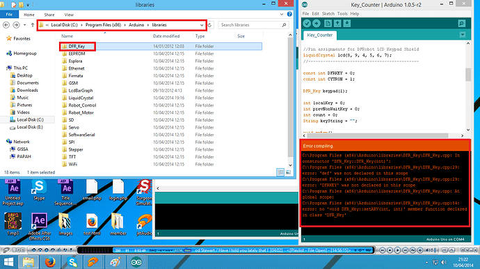

sorry if this question has been posted before .
i download some custom LCD&keypad libraries
so i try to upload that , but arduino 1.0.5 say "error compiling"
would you share your experience to help me solve this problem ?

Don't post screen captures - there almost unreadable Use copy and paste ffor both the code and the error message. Code in code tags of course.
Mark
User downloaded libraries do NOT go in the core library folder. Learn to download and install them properly.
Did you restart the IDE after mangling the install?

and this is the error message
C:\Users\gissagiswara\Documents\Arduino\libraries\DFR_Key\DFR_Key.cpp: In constructor 'DFR_Key::DFR_Key(int)':
C:\Users\gissagiswara\Documents\Arduino\libraries\DFR_Key\DFR_Key.cpp:29: error: 'def' was not declared in this scope
C:\Users\gissagiswara\Documents\Arduino\libraries\DFR_Key\DFR_Key.cpp:29: error: 'DFRKEY' was not declared in this scope
C:\Users\gissagiswara\Documents\Arduino\libraries\DFR_Key\DFR_Key.cpp: At global scope:
C:\Users\gissagiswara\Documents\Arduino\libraries\DFR_Key\DFR_Key.cpp:84: error: no 'void DFR_Key::setARV(int, int)' member function declared in class 'DFR_Key'
PaulS:
so where i can put the user download libraries ? YES i always restart my IDE after add downloaded libraries
before i got this problem , i've download LcdBarGraph libraries and put in the core library folder , and upload was success .
so i think i can download other libraries and try to learn the function of the code inside the libraries , but when i upload this libraries , it always said , i just want to know how my LCDkeypad Shield work and function

#include <DFR_Key.h> <-- DFR_Key.h has been located right ?

3rd party and user written libraries should be loaded into a folder named library in the user's sketch directory, If one isn't there then you need to create this library folder. Then specific downloaded libraries are saved in a folder with the same name as the xxx.h file along with any other files used by the library.
If you do install 3rd party libraries into the arduino core section the problem is that if and when you ever upgrade to a newer version of the IDE you will lose all your 3rd party libraries unless you manual copy them before you upgrade the IDE and then manual re-install them into the IDE's core library folder. The user's sketch directory is not erased when one upgrades the IDE so all your 3rd party libraries are not disturbed.

this is how I i try the importing via IDE . not manually copy and paste to directory :
1st. i reinstall my IDE
2nd.I open my IDE , sketch -> Import Library -> automatically my downloaded libraries located in my document/Arduino/libraries right ?
i check the file name before i upload the sketch
folder name DFR_Key
the name of .h & .cpp file , same with the folder name "DFR_Key"
but when i tried to upload the sketch
that error message always shown
