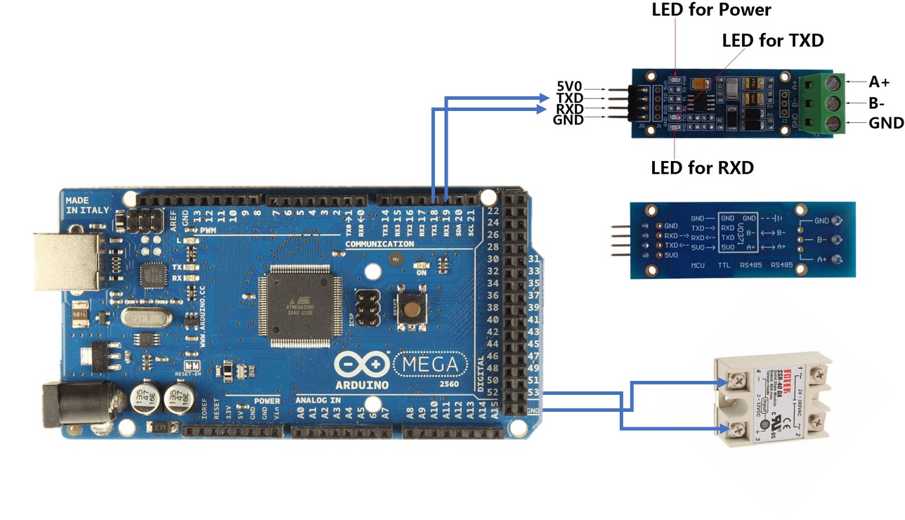

Hello,
I am working on an application in visual studio 2019 to control a 50 tonne hydraulic press. So far I have got visual studio to connect to the Arduino mega over a COM port and sends strings with the end line character '#' to the Arduino, which then drives certain pins HIGH/LOW to control SSR's, that in turn control the press.

On the Arduino I am using the ModbusMaster library to talk to a 50 tonne load cell over Modbus RTU, it pulls the readout from the press to the Arduino, which is then sent back over the comport to Visual studio, this is done over Serial1.
Code: [Select]
     ReadLoadCell = node.readInputRegisters(3, 3);
       if(ReadLoadCell == node.ku8MBSuccess)
        Current_Pressure = node.getResponseBuffer(0x02);
        Serial.println(Current_Pressure);
Both parts of the code work on their own, but when they are combined the Arduino does not respond to the end line character commands from Visual Studio. It is receiving them as the Rx LED is flashing in when the commands are sent.
I have gone through the code and have isolated the problem to this single line. I do not understand why this line of code is interfering with the end of line commands?
I have an SSR hooked up to pin 53 for testing and when the line below is commented out the LED on the SSR shows it is working as intended.

Hi !
Can you send your project Schematics ?

Thanks for all the suggestions everyone.
I was testing this system offline from the press, so it was not receiving any modbus data. I checked out ModbusMaster.H and found this line;
Code: [Select]
    // Modbus timeout [milliseconds]
    static const uint16_t ku16MBResponseTimeout          = 2000; ///< Modbus timeout [milliseconds]
I'm guessing it was putting the system into a constant delay state. I changed the delay to 1ms and everything is working together.
