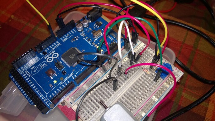

I am trying to control a simple DC motor with a potentiometer. I have pulled from a couple of online places on how to wire and do the sketch. I have setup to see through the serial window that the potentiometer is sending signal for the motor. The motor will not come on. I have verified the motor will work, I have used a volt meter and tell I am getting voltage, but it will not come alive. Attached is a picture of my setup and below is my code. Any help for this newbie will be appreciated.

I can't see from the photo what is driving the motor.

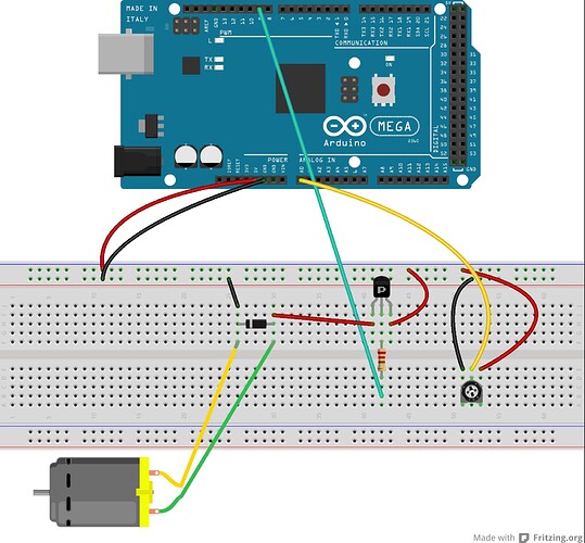

Rboin2 - Attached are my schematics.
You cannot drive a motor directly from an Arduino's output pin.
Have a look in the Playground for ways of buffering the output.
You may already have damaged your Arduino.
The schematic shows a transistor between Arduino pin 9 and the motor, so the pin is probably OK. However, it also shows the motor powered from the 5V rail of the Arduino which is almost certainly not OK.

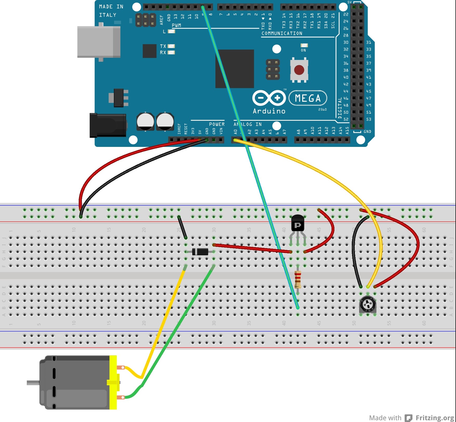

After having a day away from it, I figured out what was wrong. I should of been running the (-) to the Transistor. Below is my corrected schematics that is working. The potentiometer controls the motor as I was looking for. I did change one thing in the code.
motorValue = map(potValue, 0, 1023, 0, 255);
to
motorValue = map(potValue, 0, 1023, 120, 255);
I found it to be basically as low as it would run with out turning off. It was just to see what it does by changing the min/max.
