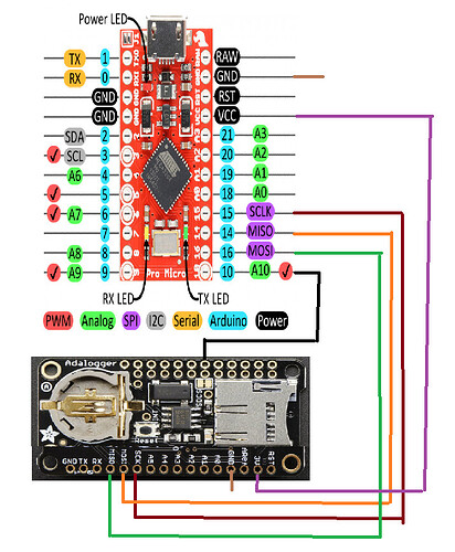

Hello All,
Back with another likely simple fix that I've been struggling with for hours.
Description: I have an Inland Pro Mico and Adafruit Adalogger, links below.
In the screen shot below you will see my current setup. Im not worried about the RTC on the board.
I understand the Pro Micro pinout to be
SD card attached to SPI bus as follows:
** MOSI - pin 16
** MISO - pin 14
** CLK - pin 15
** CS - pin 10? I've also tried pin 3
My output from the code below is always: Initializing SD card...initialization failed!
Thank you for any guidance.

you swapped MOSI and MISO.
and this module is 3V powered, not 5V.
I thought the VCC on the inland board is 3.3v.
Ive tried the MOSI & MISO in both direct and swapped configs all with the same result.

The website shows 5V and 16MHz clock frequence. If you have a 3.3V version the clock would be 8MHz.
Have you soldered the wiring, or otherwise connected it securely?
I checked and I have the 5v board. I rewired the SD logger to 3v and i still get stuck at "initialization failed" This is in a breadboard for now.

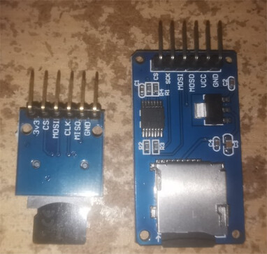

connected a different SD card reader to a Pro Micro 5V 16Mhz
same connections as post 10
worked OK - photo
  1. reader on left I used with Pro Micro 3.3V - clearly labeled 3.3V power
  2. reader on right I used with Pro Micro 5V - worked OK with VCC connected to RAW (5V) or 3.3V power - note MISO is labeled MOSO!
what are the labels on your SD reader?
EDIT: do you have any other devices connected to the Pro Micro?
