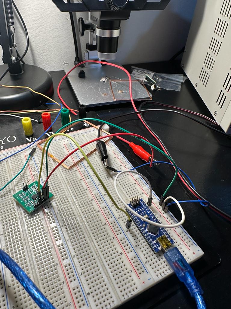

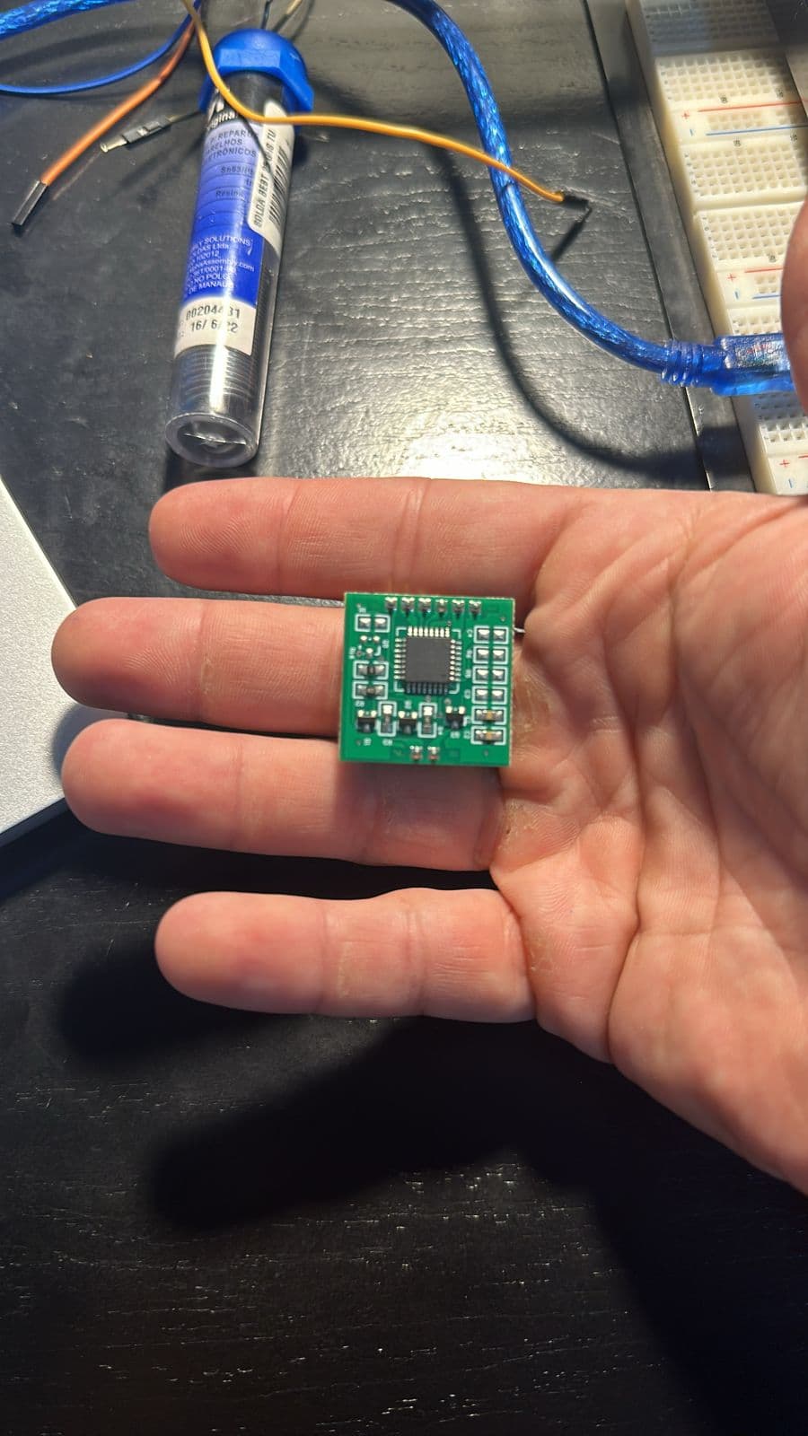

I am currently working on a project involving an RFID Animal reader, and I would appreciate some assistance with a challenge I am facing. The RFID module I am using is illustrated in the image below:
Regrettably, I could not locate comprehensive information about this module. However, I have identified that pin 1 corresponds to GND, pin 2 to VCC (5V), and pin 4 to TXd.
I have ensured that the connections were made accurately, and the Arduino Nano successfully uploads the code without any errors. The code I am employing to read data from the serial pin is as follows:

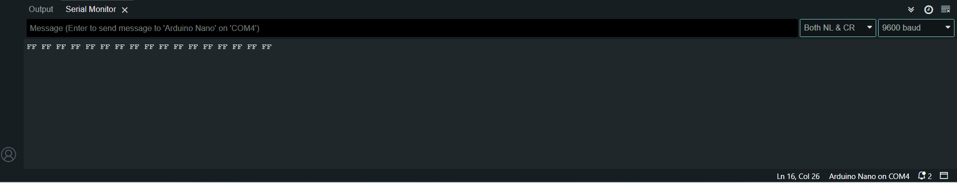

Upon approaching the animal tag to the antenna, I am receiving some information in the terminal, as shown below:
I can see that something is happening!!!!!

Are you sure the device tries to communicate at 9600 bps, not a different rate?
It really does seem that this module has no branding and no datasheet, which is definitely less than ideal.
By visual match, I am reasonably sure that your module is the same as listed here: https://www.aliexpress.com/item/33047157951.html
Pin definition:
1.GND
2.VCC
3.NC:No function, no use
4.TXD:Send data
5.NC:No function, no use
6.NC:No function, no use
7.L1:Connect to antenna
8.L2:Connect to antenna
It does seem that your wiring is correct.

Oh, looking at your image: can you confirm that your module's GND and Nano's GND are connected?
Hi all.
I identified the issue – powering the module externally while the Arduino was connected via USB. Once I established a common ground between them, I successfully extracted the tag information. Grateful for all the assistance provided!

The OP didn't connect the ground wires, thus didn't have a complete circuit. That's all there is to it

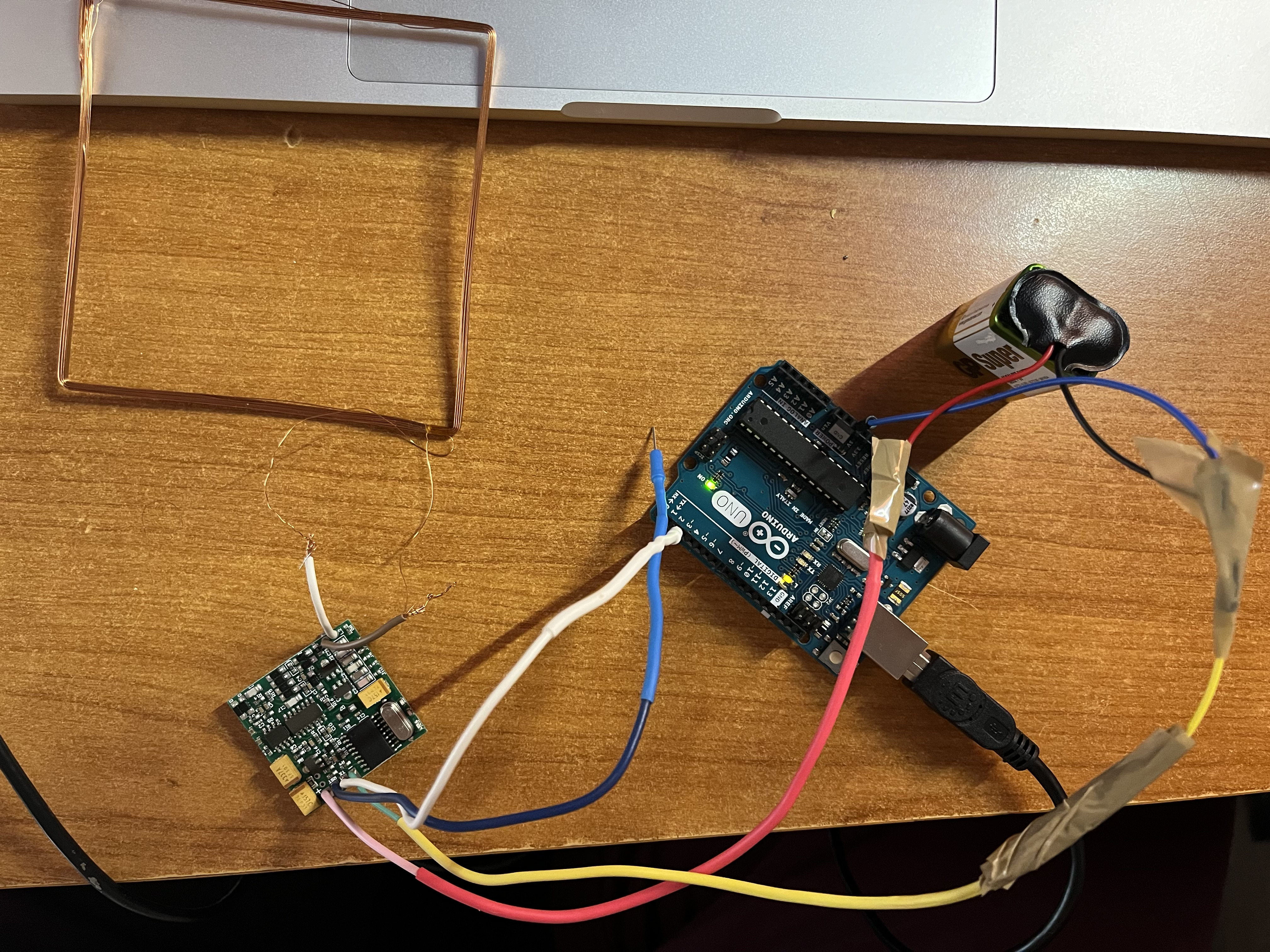

I have one last question for you, after which if I still have doubts, I'll open an issue. But the 9V battery supply is also meant to power the Arduino itself, right? So, the Arduino should not be powered through USB if I'm powering the sensor, correct? This means I can't read the data on the Arduino's serial terminal, and instead, I should use, for example, an external LCD?
Battery negative to the sensor's GND pin and to the Arduino's power supply
Battery positive to the sensor's 9V pin and to the Arduino's power supply
Sensor's TX to Arduino's RX.
Thank you and sorry for the continuous questions.
this is the my circuit now (this is only a test)
Doesn't matter. The board will autoselect the power supply it likes best.
This is a different module than the one in the original post. I do think you should start a new topic, and make sure to post any information about where your RFID module came from (links, datasheet).
It is slightly concerning to hear this. Are you sure that the module does accept 9V? We need more information (Edit: appears that 9V is okay for this module)
In the photo it looks you may have connected the 9V battery to your Arduino's 5V pin.. this would be very bad. (Edit: No I see that it is actually the ground connection.. my mistake)
I always forget about this..
You can power the Arduino by applying 9V to the VIN pin, or the barrel jack. If you have the USB connected, you will not need to power the Arduino with 9V, because it will run happily on the 5V from USB.
You can definitely still use the serial terminal.
I still don't understand what my issue might be in the photo I sent. I'll open an issue and then link it to you. Thank you so much for the help.

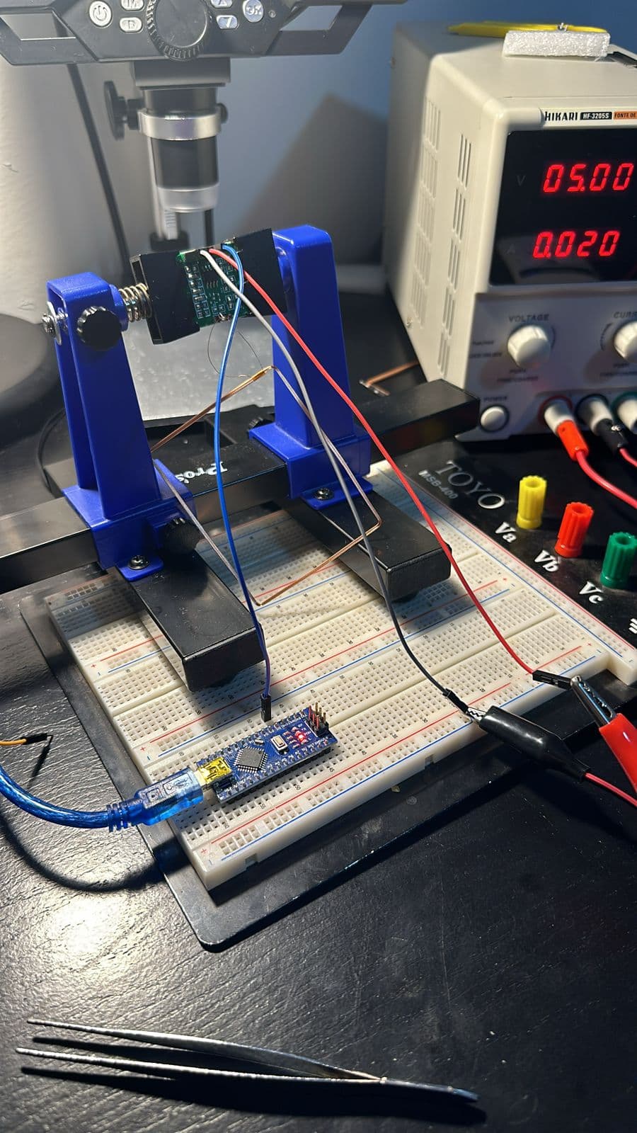

Hey, let me send you a photo of my circuit and what I did.
I used an external power source to supply power to the module. To ensure the correct data transmission to the Arduino, both the module and Arduino should share the ground connection. Therefore, I connected the GND of the power source to both the module and the Arduino.
