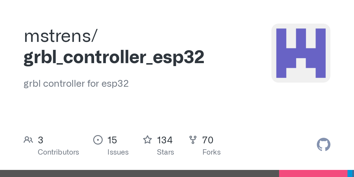

Matbe something like this will help?
Sadly it didn't helped me.
