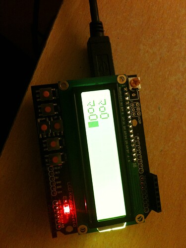

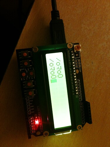

I want to use Arduino 1.0.1 and hence the LiquidCrystal library instead, which is when the following strange behaviour happens.

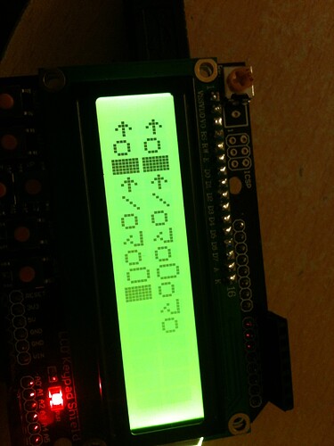

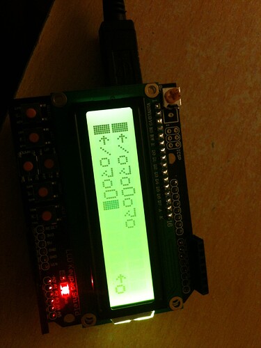

The following program gives a completely blank display on powerup, and with every subsequent Reset button push a growing garbage screen (pictures below). Oddly, a "hard reset" (USB cable out then in) resets it back to a blank display before repeating the exact same behaviour with the Reset button (so the garbage isn't random). See next three attachments and next post with more attachments.

Here is the continuation of the garbage message, which grows with each additional reset button push (and only resets with a hard reset).

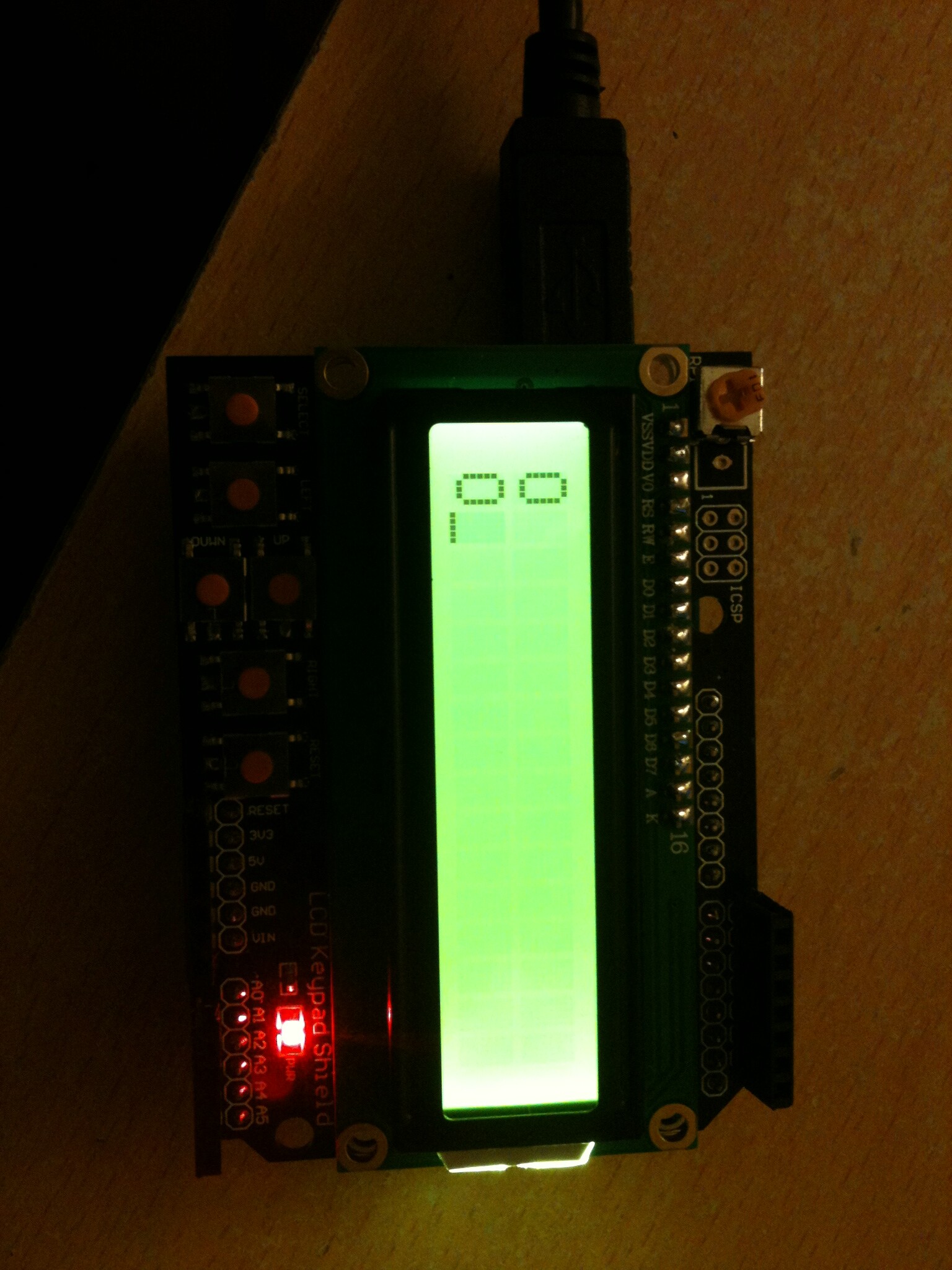

When you are testing your LCD you really should use a static message. This means that things should only be done once, in setup(), and loop() should be empty.
#include <LiquidCrystal.h>
// select the pins used on the LCD panel
LiquidCrystal lcd(8, 9, 4, 5, 6, 7);
// these have been checked with http://www.robotshop.com/content/PDF/dfrobot-lcd-keypad-shield-schematic.pdf and the working example above
  lcd.begin(16, 2); // start the library
  // lcd.setCursor(0,0);    // this is already done as part of the initialization
  lcd.print("hello world"); // print a simple message
  lcd.setCursor(0,1); // move cursor to second line "1" and 0 spaces over
  lcd.print("it works"); // a different message than above
Don
Hi Don,
Thanks for your reply and pointers.
The code above now displays a single full character block at 2,0 and nothing else.
Amadeus
I'll just add here that the following fix to get LCD4bit compiled under Arduino 1.0.0+ is working on this device:
http://arduino.cc/forum/index.php/topic,83838.0.html
Would still be good to understand what LiquidCrystal is doing differently to LCD4bit.
Why don't you try this, it has worked for others recently. Start here Google Code Archive - Long-term storage for Google Code Project Hosting. and then follow the links to LiquidCrystal1.0 and try that. It was written specifically for 40x4 displays but also works for all the others, with improved timing.
The person who rewrote the LiquidCrystal library understood the HD44780 datasheet and wrote code that follows the datasheet very closely.
The person who wrote the LCD4bit had little or no understanding of the HD44780 datasheet. If you don't believe me then just read the comments in the LCD4bit code.
Don
Works a treat.
Thank you very much for your help. Perhaps this library will make it in as the default from 1.0.2?
