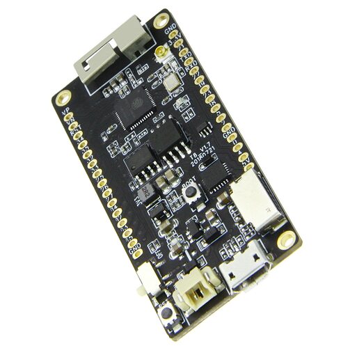

I just bought TTGO T8 board.
The board installed with "Hello World" and SD Card initialization sketch. It prints "Hello World" text and SD card files list in Serial Monitor when turn it on for the first time.
The problem is now I can't make SD card works anymore.
Board picture says the SD card CS Pin is GPIO 13 but doesn't work. Already tried changing CS pin to GPIO 2, 4, 14, 15 but also doesn't work.

if (!SD.begin(13)) {
For ESP boards the pins defintions (D0, D1, D2, etc.) are not set to the corresponding integer values. So try
if (!SD.begin(D13)) {
pylon:

Your board is an ESP32 and not an ESP8266 and Espressif managed to change that behavior again. Sorry for that.
According to the SPI example for the ESP32:
  //initialise hspi with default pins
  //SCLK = 14, MISO = 12, MOSI = 13, SS = 15
The print on the back of your board says something different. I guess it's time to use your multimeter and check the connections. Check every signal to which pin it is connected.

Already tried with multimeter but can't find CS connection on any pin.

I guess to enable TTGO T8 SD card requires something special.
According to this page, TTGO T8 comes with its own micro-python firmware.
Maybe Arduino SD card library unable to enable the SD card but micro-python can do it.
Any other ideas?
Finally.... it works.... :slight_smile: :slight_smile: :slight_smile:
Change SD.h library with mySD.h library from GitHub - nhatuan84/esp32-micro-sdcard.

Conclusion, nothing wrong with SD Card GPIO print on the back of the board.
The root of this issue cause by SD.h library which unable to detect TTGO SD card because it used custom CS, MOSI, MISO, SCK sequence.
Thanks a lot PYLON for the help.
I have the same problem but the solution i found is more easy.
I use the sketch [SD_Test] from:
[Archivo][Ejemplos][SD(Esp32)] (Sorry but i am spanish)
I only change this:
if (!SD.begin()) {
Serial.println("Card Mount Failed");
return;
for this:
SPI.begin(14, 2, 15, 13);
return;
and it works for me.
