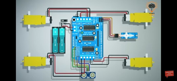

I'm using 2x 18650ithium battery 2000mAh 3.7V
This is circuit diagram taken from youtube
Hi
Do you know how to draw an electronic schematic diagram?
The picture you have posted, tells us very little.
Please post, hand drawn is fine, a schematic showing ALL power supplies, ALL component names and pin labels.
..and a link to the motors you are using please
Can you take a voltage measurement across the motors when they are moving slowly please.
That is a nice picture but in no way should be confused with a schematic. I would assume since this is your final year you have some schematic drawing experience and or training. If not there are many good tutorials on line that will teach you how to do it.
