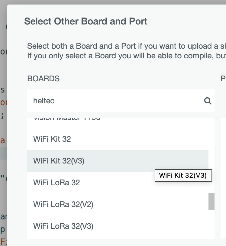

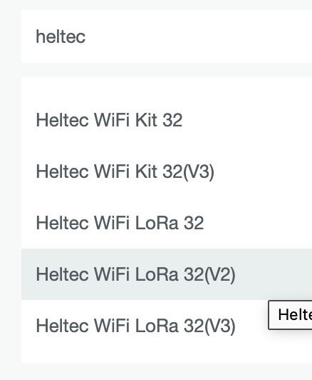

It's even better than you are probably thinking. Here I am trying to find my Heltec LORA board. I search on heltec but look at the results.
AND they are actually in there under BOTH naming styles.
