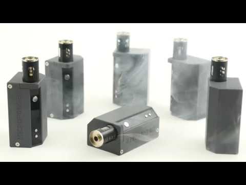

THe Smoke Unit I have made in the past from a Vape and an air pump but how do i connect it in and time how long it runs fun no idea OK ?

I was looking at using a vape to make a small smoke generator for a Halloween gag, but time got in the way and I wound up using a noisy fog generator. This year we are thinking of a no-contact vending machine type of candy dispenser. (I am working on the video projector now). But that's a different topic.

Try your vapor generator at different voltages and measure the current it draws. Then we can advise on power supply. Your led rings could draw up to 400~500mA @5V.
