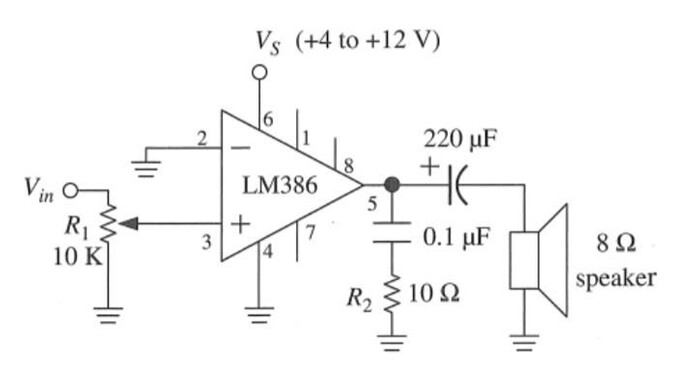

I have a speaker connected with my arduino and an sd card module connected to them to play wav files . When i turn it on the volume is very low and muffled. I tried adding an audio amplifier but it didn't work. Here is the schematic:
Which impedance?
Which Vs?
Which PSU - max. current?
I have an 8 ohm speaker and the amplifier is connected to a 9 volt power supply
What is synthesizing the sound here? The Arduino or some component on the SD card module? Can you post details, please?

Note that the output cap of 220uF with an 8R speaker impedance will cut off anything below 90Hz, so low frequencies may be poor as well. Furthermore, the 10K pot on the input of the LM386 together with a possible output cap on the audio source can form an R/C filter that will further cut out low frequencies. But since this affects LF and not HF, I assume this is not the cause for your muffled sound.

You have digital data on the SD card, and an analog audio output, so something is doing the D/A conversion.
Note: when the speaker is connected directly to the arduino uno there is sound playing but the volume is low and muffled but when connected to the amplifier there is no sound

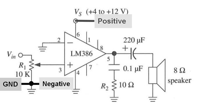

Is the amplifier ground connected to the Arduino GND?
No.

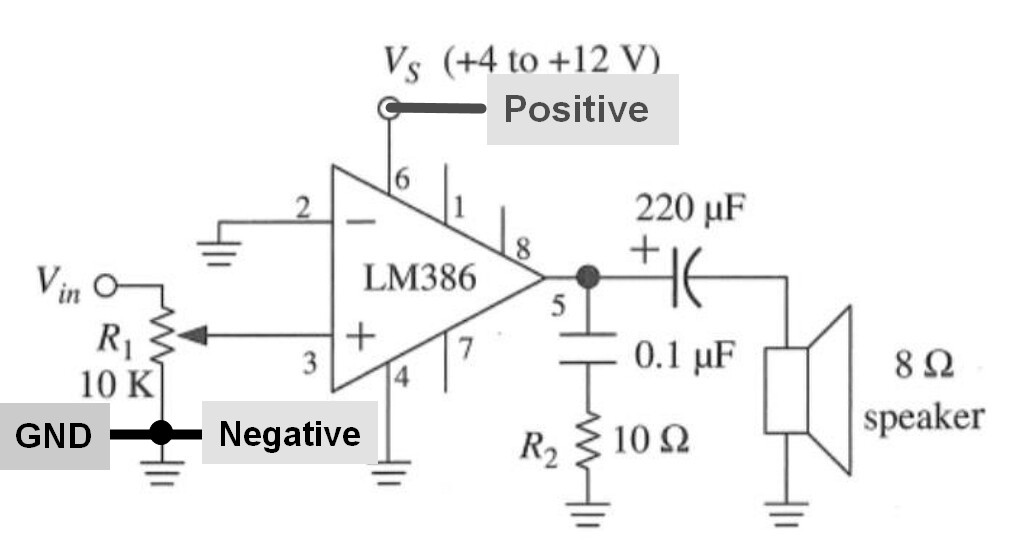

You mean that i should connect the positive of the amplifier to the power supply and its ground to the arduino
The positive of the power supply connects to Vs.
The negative of the power supply connects to the amplifier ground.

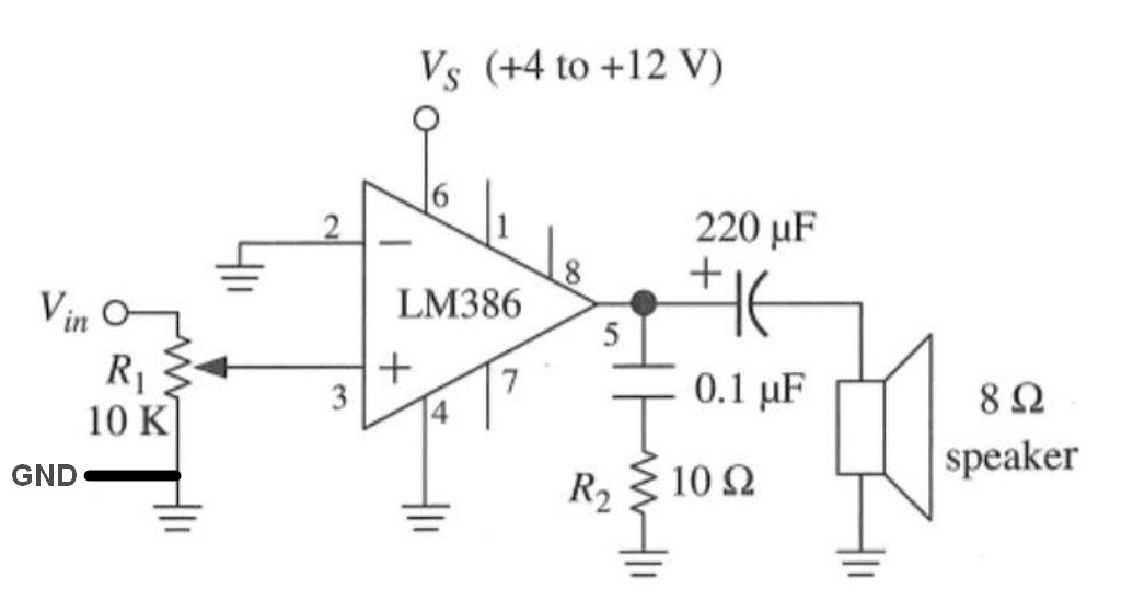

The GND of the Arduino also connects to the amplifier ground.
