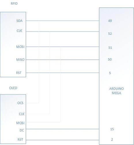

Show your wiring diagram. You are using pin 53 for two different purposes. This is possible but unlikely.
Both parts of the program work when run separately so I think the wiring is OK.
Wiring image attached. Top module is the RFID device.
When I run the code included the display writes one page then stops so it doesnt loop through both test patterns???
Actually I think the page that does display at the start is just the last page written to the display from doing a test with 'good' display code.
When I run the full program with both the RFID and display code (posted earlier) the display just wakes up and reloads the last page it saw. So while the pattern code is running (I can see that in the serial monitor time delay) the display isn't getting written to so I must be doing something wrong with the pins on the display. The RFID parts works fine.
You can not use 53 for both devices as ChipSelect, only MISO, MOSI and CLK are shared.
Thanks
So if I move one of the 53's away to another pin are the rest of the pinouts OK?
Who knows? The wiring diagram is incomplete. Good wiring and good code are both important, and the code must reflect the wiring.
It is probably OK, but I do not know your wiring.

I moved RFID (CS/SDA) to pin 49 and changed the code to call the RFID pin as 49.
New drawing is attached.
It is still only giving me snow on the OLED.
I will do some more research later but it must be a simple error. Both OLED and RFID sets of code work independently, I am just trying to get both working on the SPI together.
Appreciate the help
You wanted to move one pin away from 53. Connecting both now to 49 makes it worse.
The drawing shows three unconnected pins on the OLED, so it is no wonder that the OLED does not work.
The last program that I saw used pin 53 twice, but pin 53 is not showing on the drawing at all.
The last program that I saw did not do anything with pin 49, but the drawing shows it as in use.
If you cannot provide written information and you will not follow written instructions, this is never going to work.
vaj4088:
No, look more closely. :wink:
The drawing shows all the connections on the OLED, but in a very pale grey which is being missed by
people - redo the drawing in monochrome please.
I had to look very closely at my computer monitor’s screen before I could see the other connections, and I had to get the adjustments just right. I can see the wires if I reduce brightness and gamma, and increase contrast. It is a lot of work, and has been unnecessary until now.
I see that MOSI is shared. I see that CLK is shared. That is good because it makes good use of SPI.
I see that OCS and SDA are shared. This can’t be good. I admit that I do not know what SDA means here (SDA is often used for one of the I2C wires), but I am certain that it should not be shared with OCS of the OLED.
I still have not seen the code that could work with this wiring.
Why should anyone be expecting that three of the wires are depicted differently from the other seven?
Yeah - that image is not good due to the colors chosen. Never underestimate the impact of improper monitor adjustment on readability. With light grey and white, it is particularly bad - for years back when I was playing this online game, I was complaining to friends about how unreadable the text on the updater was. Eventually I complained on the forums for the game, and people were like "i can read it just fine". Turns out the contrast and brightness were misadjusted on my monitor; readjusting them not only fixed that specific problem, but made everything look way better. But the lesson for people making images and websites for others to view is to make sure you pick colors with high contrast! Don't assume that everyone else's monitors display colors the same as yours, and not everyone's eyes are equal.
So, the SDA line on the RFID is CS in SPI mode? Okay - you should have labeled the pins more clearly IMO (ideally, list the function of each pin in the post or on the image).
CS for each SPI device must be unique. That's how you tell the device you're talking to it with SPI, so OCS needs to be on a different pin (no matter what OCS means in this context, connecting it to the CS line of another device is definitely wrong).
New black line image attached…
The top module is the 522 rfid unit which has an SDA pin which I believe is the CS pin?

It still seems to lock out the OLED???
Any help guys?
As both programs work independantly I must be doing something wrong in the wiring or definitions?
Thanks
You could also have a SPI device that does not release all pins when not selected.
I know of some SD card breakouts that block any other SPI device without modification,
I also had to isolate a RC522 with a level shifter/buffer with inhibit/enable to make it work alongside a NRF24L01+.
with both modules wired up and powered and connected as in the previous attached program, if I load the OLED code only it works. If I load the RFID code only then it works.
But when I load the combined code the OLED just display coloured snow???
If I disconnect the MOSI and CLk links to the RFID and load the combined program the OLED still doesn't run.
BTW everything runs from 3.3v and as each separate piece seems to run with the MEGA on its own I assume I don't have any level shift problems...
So this standalone OLED program runs fine on hardware SPI…

But when I paste this into the Main program listed earlier, the display just freezes. The RFID code in the Main program runs OK on its own as well, its just the combination that is wrong. Both modules are 3.3v, both seem to have OK wiring in that when both are wired up together the OLED and RFID (separated) programs work OK.
This is driving me nuts…
