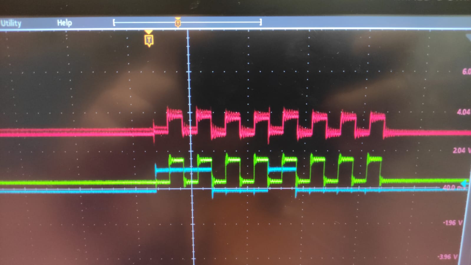

For clarity: the output of the main, real board is this:
where red is CS, blue is master clock propagated out and green is data (I was sending 5 in 8 bit so you can count to 00000101) Ignore the clock div, that will not be final.
The problem is that I cannot receive from the ESP32 side.

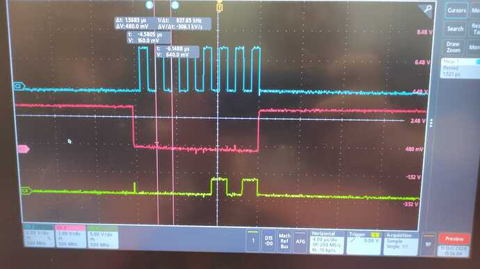

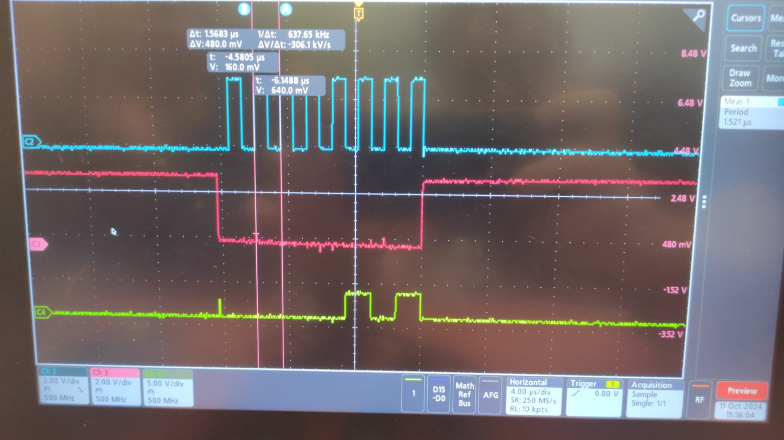

I'll attach what I got from the ESP32 master:
without manual piloting the CS pin I get this:
the red channel is CS and it's just noise.
When manual piloting the CS Pin, things get a little better:
but, as I already said you can clearly count at least one clock strike since the CS goes low and the clock is propagated, and at least 2 clock strike after the clock goes low before rising the CS signal. This is clearly not optimal. In addition, in both mode the ESP32 on the receiving side never get usefull data (mostly 0)

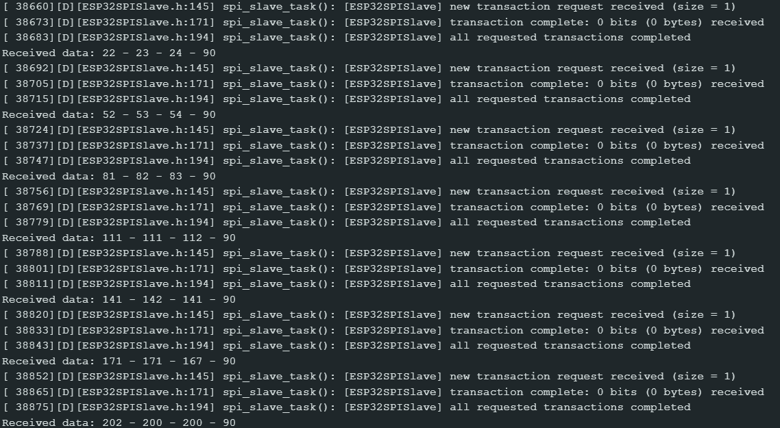

and this is the output I'm getting:
It's strange that it says I received 0 bits and 0 bytes but still print something. In addition sometimes the first three printed number are correct, but the fourth one is always wrong.
So then, you're using SPI_MODE1. OK, why not but you of course need to make sure this is SPI_MODE1. I mean first example (post #8) used SPI_MODE0 !
Code post #17 has a transfer timeout of 1ms, that's rather short, are you sure the master transmitted the data (at least one byte) during that millisecond ? (see note below) You didn't check the number of received bytes :
numOfReceivedBytes = SPI_SLAVE.transfer(NULL, rx_buff, BUFF_SIZE, MAX_MS_WAIT);
Based on the output you get, I suspect it didn't receive anything and simply timed out.
Printing data ? There's always data inside a memory byte. Whether it's garbage or not depends on the program. Output shows garbage in my opinion...
