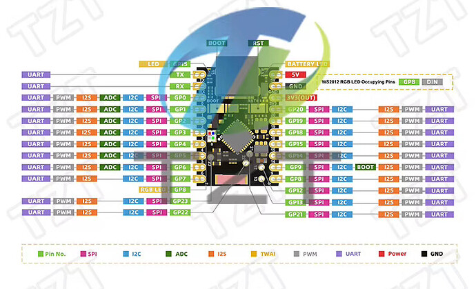

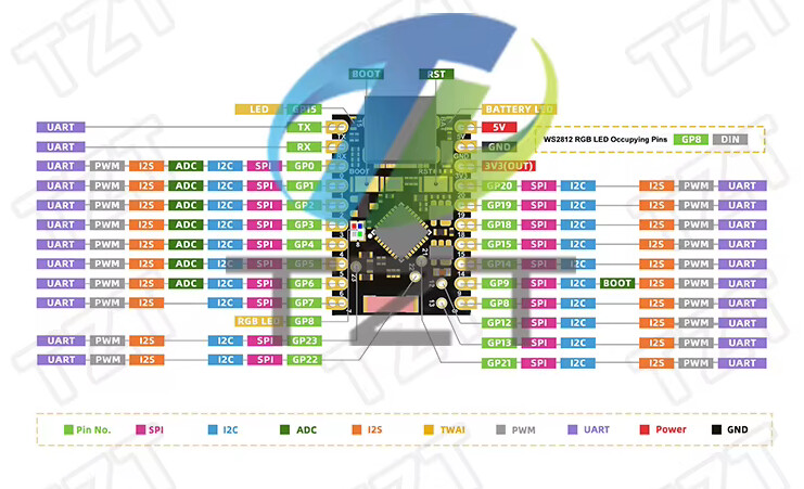

I have a esp32-c6 supermini from TZT. This board:
https://www.tztstore.com/goods/show-7996.html
I want to connect a ST7789 1.3 oled display (240x240) to this module.
My display board does not have CS pin, so I understand that I should initialize the display with:
Adafruit_ST7789 tft = Adafruit_ST7789(TFT_CS, TFT_DC, TFT_MOSI, TFT_SCLK, TFT_RST);
tft.init(240, 240, SPI_MODE3);
But I don't know which pins I have to use for SCL and MOSI on esp32-c6 supermini.
How can I find the correct pins ?
I followed :
But I need MOSI/SCL pins.
Thanks.
I expect you can use any gpio pins, but try if it defaults to gpio6 and 7.
The board datasheet is the usual method, but I bet this is a modern board and almost any pin can be used.

But there is no PIN 21 on this board ???
I found the PIN 21. It is in the middle of the board.

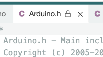

How can I change SCK to another PIN ?
Probably in the begin or init methods, but if I can't see the code I can't tell you. Look at the begin and init member functions in the library, or just hover the cursor over the begin or init statement. You may need to do a compile first, and it won;t hurt to do a highlight the library hdr and rt click then goto definition. I am including the goto definition screen grabs. The last one is the read-only tab now open in your sketch.
I really didn't understand what you meant. Did you read what I wrote ?

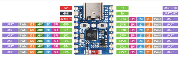

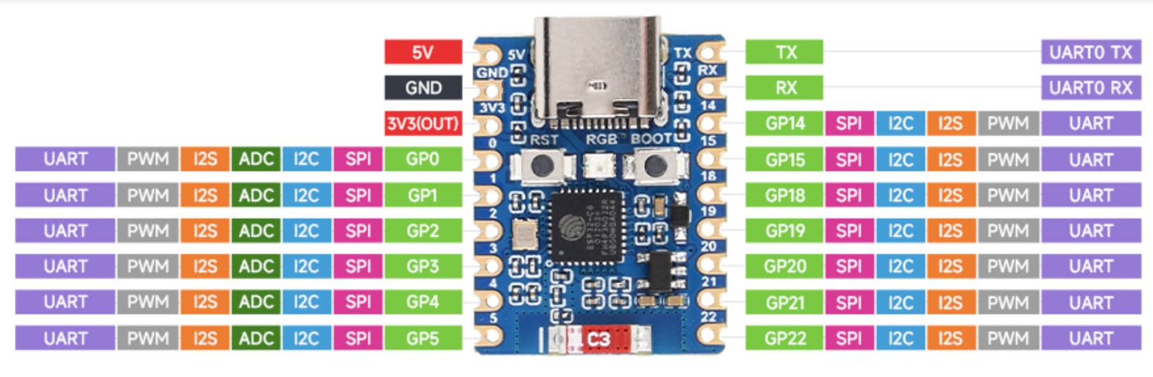

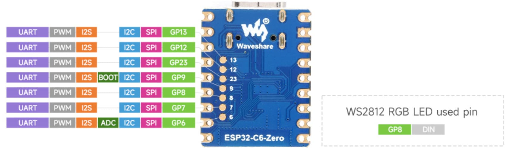

Post #3 shows all the pins available for SPI.
that is Waveshare's esp-c6-zero board. Mine is TZT's esp-c6-supermini
Doesn't change much, concerning SPI interfaces.
