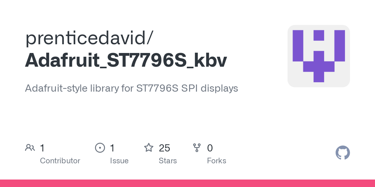

Try to use Adafruit GFX library.
I found this but I'm not sure it can be used for UNO R4:
Since I had recently purchased that same display, to update our ST77xx library to support the ST7796. I had also tried out the library TFT_eSPI.
