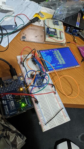

@ZinggJM Unforunately no luck with trying the commands you sent. The code compiles and uploads to the Minima but I'm getting a white screen on the display. May I ask what your connections are?
Yes. I used a shield with the same wiring I use with e-paper displays:
// mapping suggestion for AVR, UNO, NANO etc.
// BUSY -> 7, RST -> 9, DC -> 8, CS-> 10, CLK -> 13, DIN -> 11
from GxEPD2_wiring_examples.h
I had recently created this shield with I2C kind of level converters for use with SPI TFTs, as some TFTs didn't work or didn't work reliably with my shield with resistive divider (10k/4.7k).
And I connected VCC to 5V, as my display has an LDO.
Your resistive voltage divider for level conversion may be the issue.
-jz-
@ZinggJM Something like these for the level converters?
I'm at work but I soldered a 2pin header on J1 on the back of the display as per here and here, so I might try running everything at 5V.
Yes, I used the same kind. There are also 8bit bidirectional level converters, but I had none at hand. These have stronger driving capability for low and high, but use more power.
I don't understand their recommendation, as this will stress the controller of the display.
It just avoids the voltage mismatch.
Surprisingly, the signal after the I2C level converter looked good, even with the capacitance load of a 10:1 scope probe.

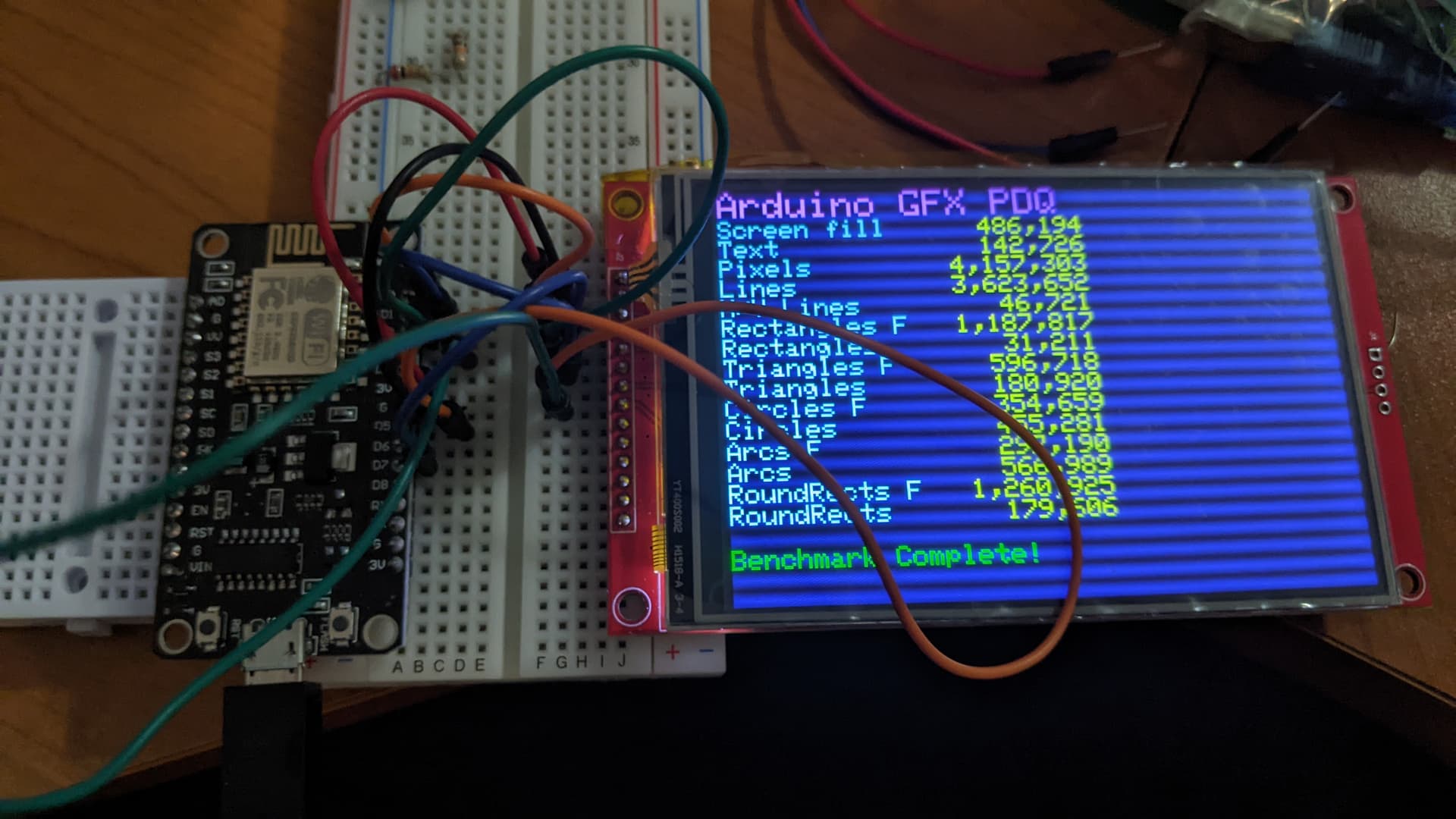

@ZinggJM instead of rushing with the jumper method, I decided to test with a nodemcu esp8266 I had lying around. Following this guide, I was able to get it working!
I then tested PDQgraphicstest but for some reason I only got a blank/white screen, so I decided to condense everything into one file here.

So I'm now going to order some of those level converters for the R4, hopefully I can update you in the next couple of days. Thanks!
@ZinggJM good news with the level converters!
 * Modified from PDQgrphicstest example of Arduino_GFX.
 * Run on Minima + 480x320 ILI9488 SPI TFT.
#include <Arduino_GFX_Library.h>
#define TFT_CS 10    //D10 or SS
#define TFT_RESET 4  //D4
#define TFT_DC 5     //D5
#define TFT_MOSI 11  //D11/MOSI
#define TFT_SCK 13   //D13/SCK
#define TFT_LED 3    //GPIO3
#define TFT_MISO -1  // not used for TFT
#define GFX_BL TFT_LED  // backlight pin
/* More data bus class: https://github.com/moononournation/Arduino_GFX/wiki/Data-Bus-Class */
// Arduino_DataBus *bus = new Arduino_HWSPI(TFT_DC, TFT_CS);
Arduino_DataBus *bus = new Arduino_HWSPI(TFT_DC, TFT_CS);  // UNO
/* More display class: https://github.com/moononournation/Arduino_GFX/wiki/Display-Class */
Arduino_GFX *gfx = new Arduino_ILI9488_18bit(bus, TFT_RESET, 3 /* rotation */, false /* IPS */);
 * End of Arduino_GFX setting

Thanks so much for your help!
Please read
Thanking the people who helped you
And consider if you have done this correctly.
I would have thought that @ZinggJM deserves the credit for telling you the information that allowed you to get it working.
