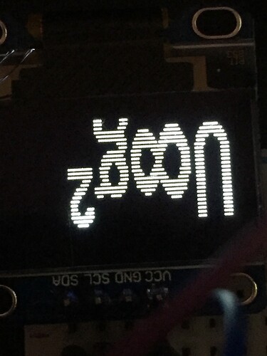

I bought a stock SSD1306 128x64 i2c 0,96" oled module.
Following the instructions using u8glib and creating a "hello world" print.
Hello world appairs in the oled display, but every second line are blank and text, text is chopped.

I tried their examples, all working except that every second line was missing.

I confirm it. It communicates flawlessly on 0x3C, and it also works together with other devices I tried on the i2c bus. i2c scan finds it in a blink. The "snowflake test" works, except the odd blank lines.

Here are pictures using the two constructors, the pictures filenames reflect each constructor from "hello world" example:
http://student.ing-steen.se/arduino/
Thanks, looks indeed strange.
Can you post the code for your Helloworld? Especially: Which font did you use? Somehow I does not look like the default HelloWorld.ino.
One more question: Can you post a picture of the u8g2logo example with the ALT0 constructor?
Oliver

The u8g2logo:

Thanks for the u8g2 logo picture. I think the display is brocken: The second half of the internal display RAM does not work. Your display should work correctly with U8G2_SSD1306_128X64_NONAME_1_HW_I2C constructor, but it doesn't.
Yet I still have some doubts: Are you sure it is a 128x64 display? It looks more like 96x48 version.

Ok, I got a new oled display of exactly the same type.
Unfortunately the result is the same, no difference.
So, now what ?
psteen:
So, now what ?
UPDATE!
I changed back the constructor to
U8X8_SSD1306_128X64_NONAME_HW u8x8(/* reset=*/ U8X8_PIN_NONE);
And recompiled my application, now it works as it should!
I tried to change back to the oled display that I suspected to be broken, and now confirms it is broken ot works differently than the other exactly same working device!
Device broken!
