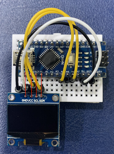

Hi guys!
I'm using an Arduino Nano, and an SSD1306 display for my upcoming project, and for some reason the display is blank.
these are the things that I have tried so far:
  1. Used the library example to write some designs to the OLED (didn't work)
  2. Tried to get the i2C address of the OLED using the serial monitor (code found on github); and again, it doesn't show anything, only "scanning for i2C devices".
Please guide me on what I am to do.
Here is the Amazon India link from where I bought the same if required: https://www.amazon.in/gp/product/B01GNZEM22/ref=ppx_yo_dt_b_asin_title_o00_s00?ie=UTF8&psc=1
The pins came pre-soldered, should I resolder in case a connection or two was not made correctly?
Please help,
Thanks in advance,
Taran.
Read the forum guidelines.
Post a photo that clearly shows how the display is wired to your mystery Arduino board.
Post your test code in code tags. Use the IDE autoformat tool (ctrl-t or Tools, Auto Format) to indent the code for readability before posting code.
Without seeing your code and a schematic of the project it is going to be difficult to provide help
Please post your code following the advice given in the link below
The picture at Amazon shows 0x78 and 0x7A as a possible address. Check the underside of the PCB to see which one is wired on yours.
Start with basics :
How have you wired the screen?
What model of Nano have you got?
What actual code are you using?
imagine going to a shop just saying "I want to buy" not a single word more
Will your shopping be successful? NO!
You will be asked "what do you want to by?"
If you just answer "things" you might get thrown out because you are too uncooperative for creating money for the shopowner.
The information you have provided about your project so far is as poor as a "I want to buy"
that's the reason why the others are asking for more details.
post your complete sketch:
You should post code by using code-tags
There is an automatic function for doing this in the Arduino-IDE
just three steps
  1. press Ctrl-T for autoformatting your code
  2. do a rightclick with the mouse and choose "copy for forum"
  3. paste clipboard into write-window of a posting
post a schematic that shows to which IO-pins you have the OLDE connected
reason: depending in the code you used you may have connected the OLED to the wrong IO-pins
post pictures of both sides of the OLED display
reason: trying to identify if the display needs 5V or 3.3V to operate
post pictures of the arduino that you are using
reason: identify which IO-pins are connected to the hardware I2C-interface
The microcontrollerworld is not superstandardised like USB-devices.
You have to take care of a lot of more things than just
"does the plug fit into the socket"
If english is not your native language use google-translate.
posting another short posting is just like repeating to say
"I want buy" in a shop
best regards Stefan

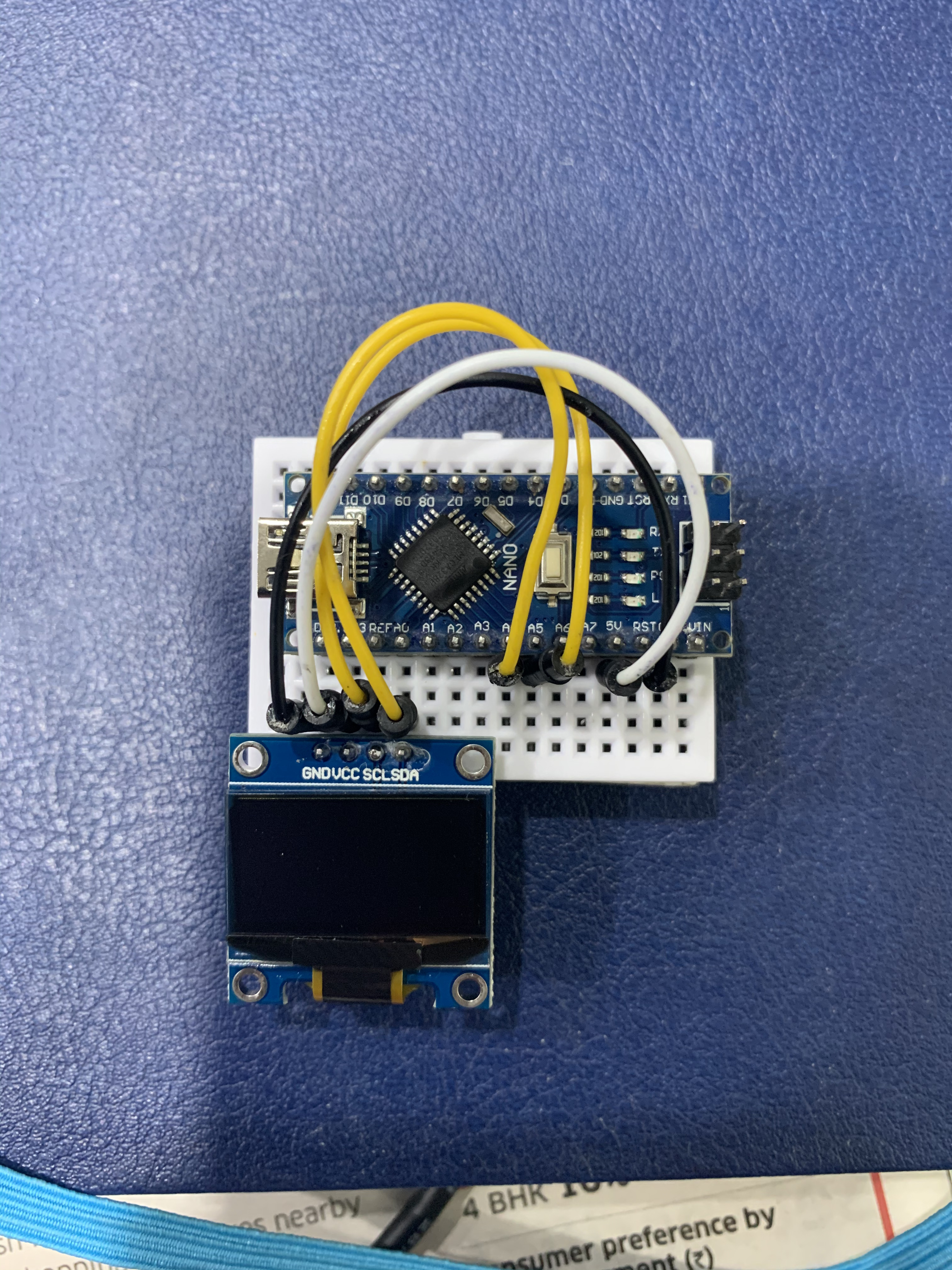

OK, I am attaching a photo along with the code as well.

et voilá there the error is:
this can't work.
Your OLED-SDA-Pin is connected to A0 too
Your SCL-OLED-Pin is connected to REF
Your Vcc-Oled-pin is connected to the Nano 3,3V pin
and connected to the nano-5V at the same time
your Oled-GND-pin is connected to D13 and to ground
I'm wondering if your nano is still alive.
Saving too much money on equipment "pays off" through re-buying components.
best regards Stefan
And looks like both sides of the nano are connected together via that board.
For the poster - all vertical pins are connected together on your proto typing board, as shown by the red lines drawn by the previous responder
The nano is working, just pulled it out of another project where it was perfect. Will rewire and circle back.
