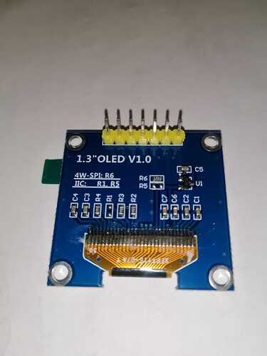

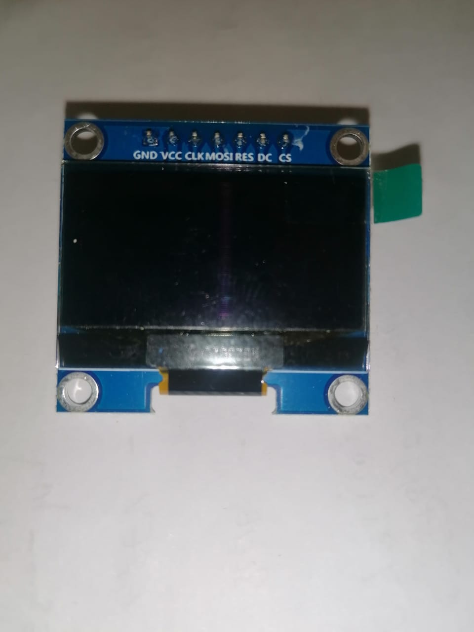

Hi, I have purchased these a while back and would like to use it on a project where I previously used the 0.96in I2C OLED display with a Arduino Pro Micro. I have found the following information online and would like to verify this before proceeding to wire up everything:
  1. Resistor R3 (4.7Kohm)which has a 4.7Kohm resistor must be moved to R1
  2. Resistor R6 (4.7Kohm) to be moved to R5
  3. Pins DC & CS to be connected to GND
  4. Pin RES to be connected to VCC
  5. Use pin CLK as SCK (Pin 3 on Pro Micro)
  6. Use MOSI as SDA (Pin 2 on Pro Micro)
Is there anything else I need to do / check. The previous project does have the following in the setup ==> "display.begin(SH1106_SWITCHCAPVCC, 0x3C)" ; using the SSD1306 library

If the display is a SH1106 whats the problem with using Adafruits SH110X library as in;
#include <Adafruit_SH110X.h>
Just curious ..............

Thank you...I don't think i have tried that but will do. I powered up the Arduino and the display connected as per my initial description....unfortunately the display does not light up at all, so there is definitely something I missed along the way. I will remove the display tomorrow and test another one, failing which, I will revert to the original 0.96in display.
