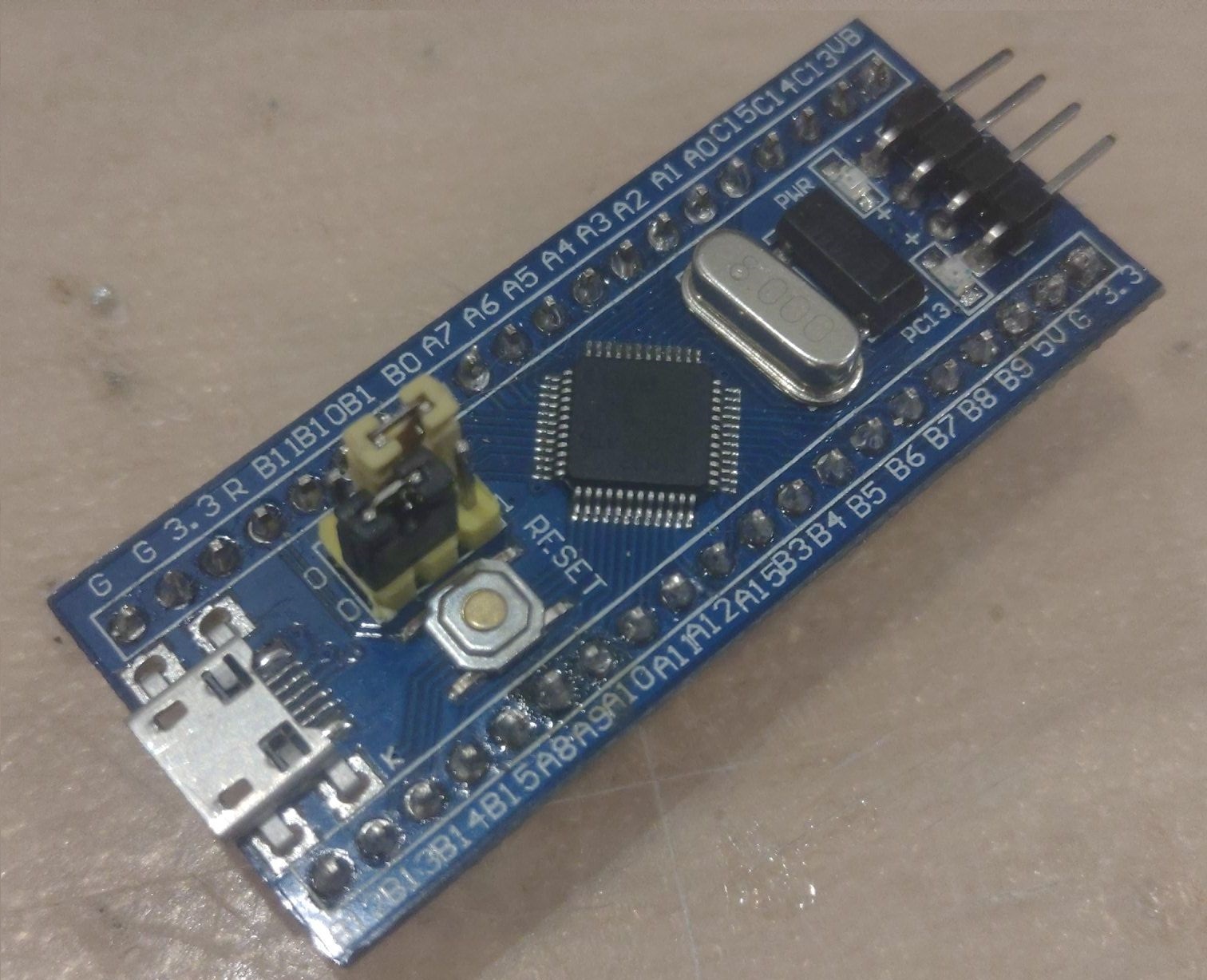

Hello,
this is my second topic about these 2 components. A few months back I managed to get my little project working, but I want to rebuild it and it does not seem to work anymore.
I wrote my connections down and I didn't change my code. But after a few days now of trying I can't get it to work again.

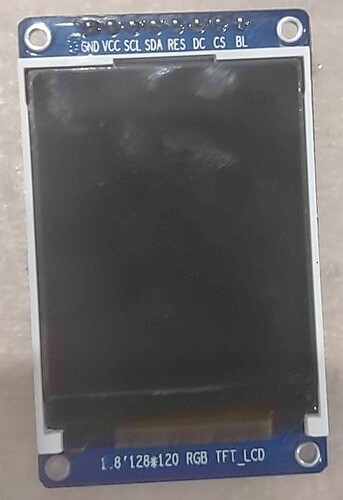

I am using a STM32F103C8T6 "Bluepill" with a ST7735s 128x60 tft display. The display has these connections: GND, VCC, SCL, SDA, RES, DC, CS and BL.
My current setup is this:
GND - GND
VCC - 5V
SCL - PA5
SDA - I wrote down PA6 but I think I ment PA7 but I tried both
RES - PA0
DC - PA1
CS - PA2
BL - N/C (sometimes on 3.3V, I dont use it)
I am using the up to date version of stm32core (STM32CORE) and I have updated all my libraries. I use the arduino IDE btw.

Here are some pictures if that helps :smiley:
Any help or advise would be much appreciated.
Did you find the problem?
Did you move the yellow jumper on the Bluepill back to boot1.
I tried the exact same thing and get Adafruit_GFX.h no such file.(about a month back).
But on a Nano it compiles so the Bluepill is still in a very gray place for me.
Yes ofc, i would upload with boot set to high and then place it to low and restart. Normal programs and examples just worked fine
No i have not, i am still trying
You are probebly using the wrong libraries. Mine do compile and upload, the screen just doesn't initialize.
