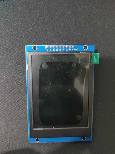

I am trying to run ST7789 SPI 2.8Inch TFT display with Arduino Nano but it doesn't just work. I have validated the wiring on the circuit. Saw many tutorials, but it doesn't just work. The display's PCB is below

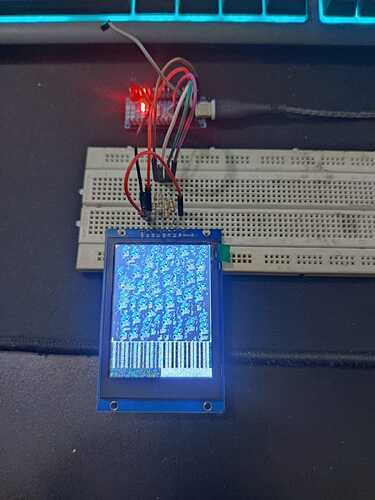

I used the FAST ST7789 Library. Please note that, in total of 3 hours of struggle the hello world example displayed for about half of a second and then flicked away and then no overall output. This only happened between my struggle to display something onto the screen.
I used multiple other Arduino Nanos as well as an Arduino Uno. But it didnt work as well.

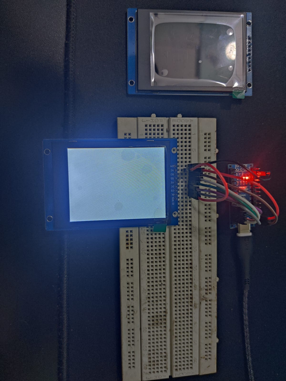

I just tried a different diagram that I saw in the this video.
The screen is turning on but its just a white light. I am using the same Fast ST7789 library.

Worked with some different wiring. Needed to remove CS pin. FIXED!!!
